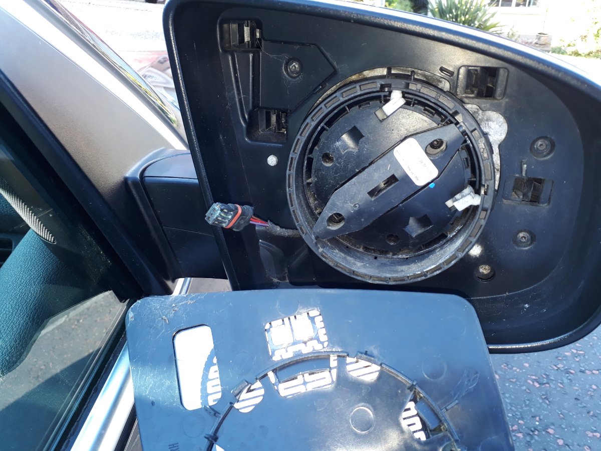

Drivers side mirror wasn't heating on my e70 2009 but passenger one fine so fuse ok and I assumed I needed a new glass and bought one of ebay.
I removed the old one and the plug isn't connected so no wonder it didn't work .

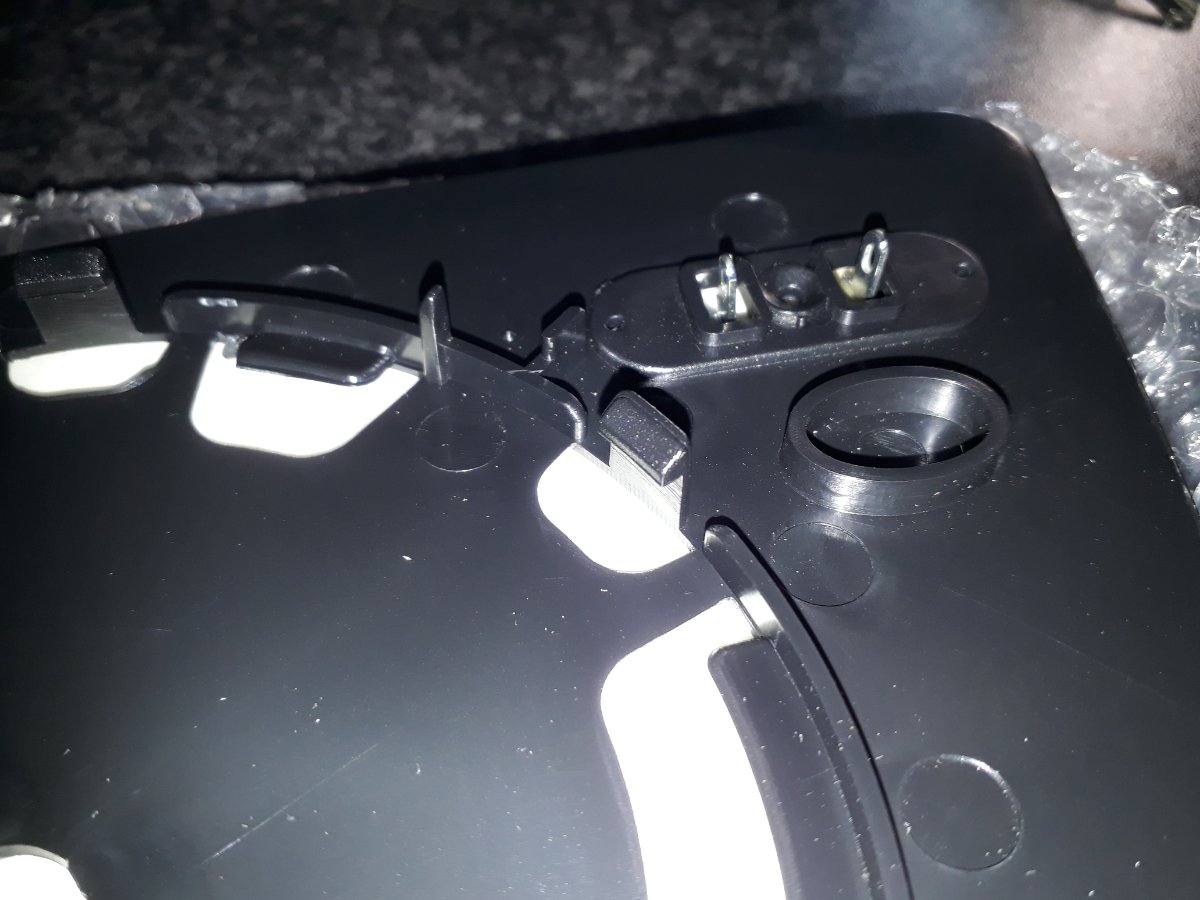

I can't see this connector for sale either ,anyone changed a glass before as one from a dealer is very expensive ? There are 2 pins on that glass I took out and 2 pins on my new one but not exactly the same :?

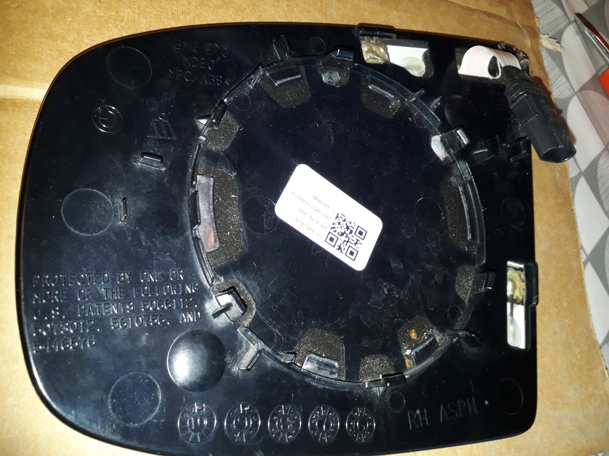

One I bought

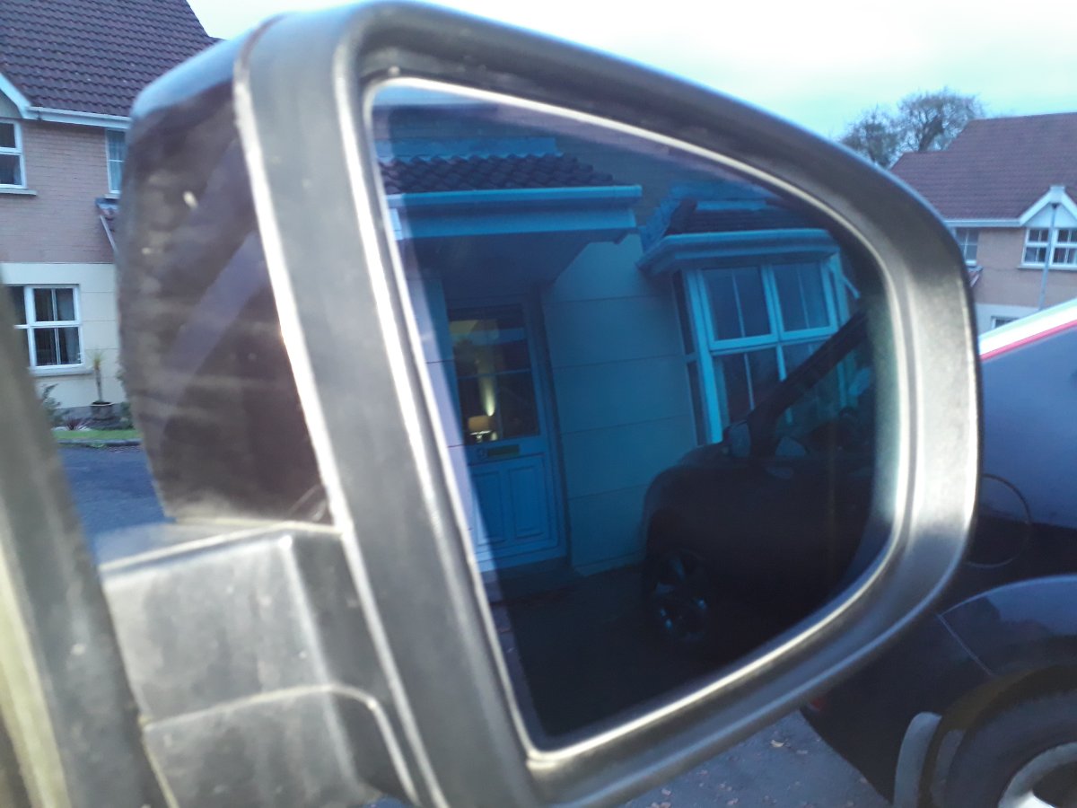

I did notice watching the passenger side mirror it turns blue quite noticeably as it heats up when parked then back to silver again as it cools just last week ! bugger just seem how much a genuine glass is for these at least 300 quid :o :rofl: scared to even go near the passenger side incase I break it :cry:

The lugs on the one you have bought are for soldering to.

Thanks for reply :D The colour change is very subtle on the working one and its only in lowish light I noticed it and I've had the car a year now ! cycling with the heating , it leaves a border of 6mm round the edges which doesn't change .I see any pics of one auto dimming ones have the little border round the edge on the glass and more gold in the centre so I think its right .

I was briefly watching the working left one tonight driving in the dark and it darkens a slight blue tint with headlights behind . I think a whole mirror from a seller who doesn't know what they have might be the cheapest answer but most clearly do as they are for sale without the glass and its so hard to tell from pics what's what :D

One used mirror later bought for the glass and working fine ...took a chance on it as its hard to tell from pics if mirrors are auto dimming or not unless its at the right angle !
Pic shows darkening when light shone on interior mirror :thumbsup: I heated the mirror and tried to blow hot air behind the glass before removal ,you can tilt the glass by pressing on it , The centre disc came of the motor with the glass and getting this of the new mirror glass was trickier than it should be , was scared of breaking the glass as you have to lever the tabs quite a bit to release it. My connector pins in the mirror have some corrosion as they have been exposed to the weather for a while which they wouldn't if plugged in but it seems to be working ok , worse case I take the wiring from the new mirror if needed 8)
