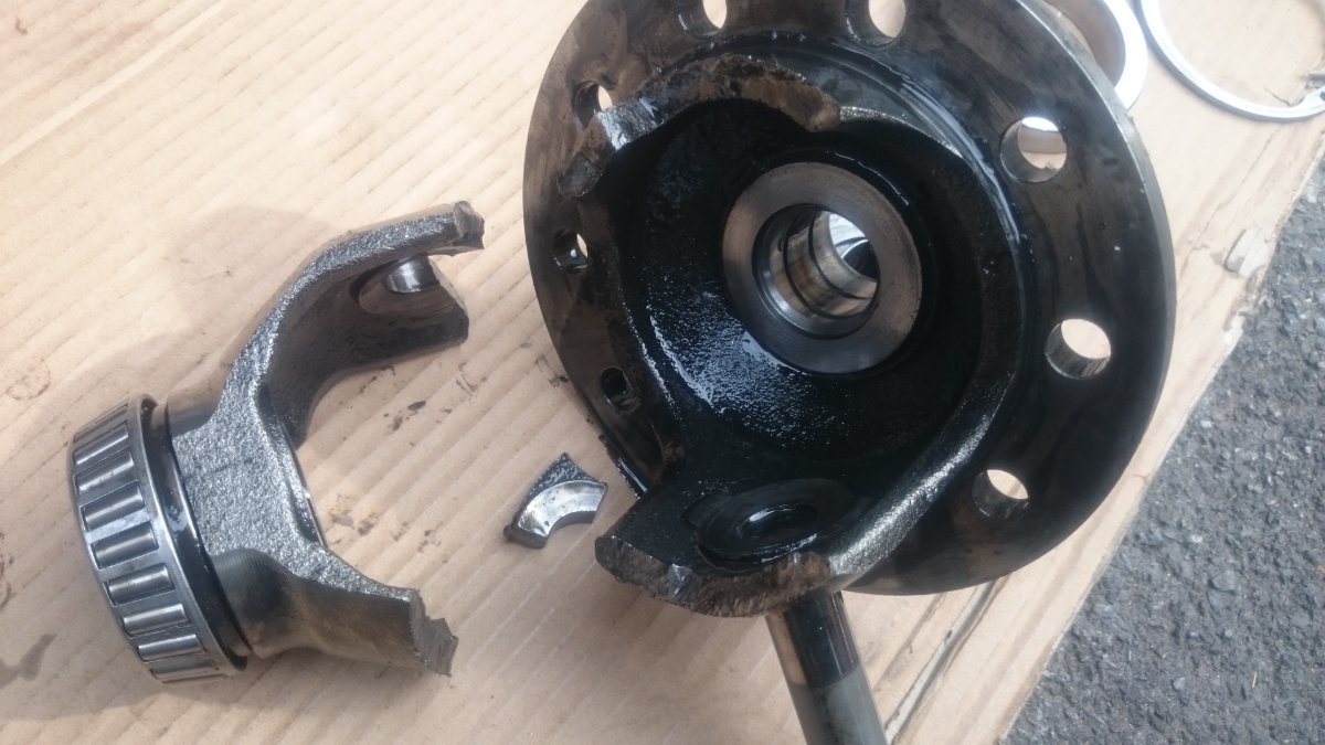

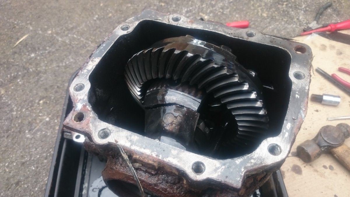

So pulled the diff out this morning and stripped down to find root cause.
Guess Im now searchinf the breakers for a very rare 3.91 ration diff.

Re: do diffs do this???
Yep, that'll do it! That diff is toast.
Mind, it must have taken some abuse to go like that.
I don't know about rare. There are several on everyone's favourite auction site, but they aren't cheap.

I'm no expert, but I wouldn't have thought that damage is tyre-related. It's the sort of thing that happens to drag racers.

My rear diff on the 4.6 went at 72k full BMW history and correct size Michelin tyres. At that time BMW quoted over £900 just to supply the diff plus labour which back then meant a £2k+ bill from BMW and they keep the parts so no evidence?
The BMW Specialist I use managed to get a rebuild kit from the US. Parts, shipping and rebuild came to less than the cost of a new diff from BMW. I have to say my diff was not a complete bag of bits I don't know if the one pictured could be saved I would be concerned about hairline cracks in the casing with that much damage.

From memory the kit was pretty comprehensive I will see if I can dig out the invoice if I still have it which was itemized. My diff was making uncomfortable noises the bearing and seals were gone on the drivers side and the bearing was on it's way on the other side. The one pictured looks as though its exploded ??
Believe it or not the car was driving before i took it apart. - it had a judder - almost misfire like above 40mph - esp under load - but free wheeling in neutral - even at 70 - smooth as butter.

Surprised that was still driving ,Did the bearings fail ? Not sure why diffs are expensive given the modest value of these cars now .Cheaper to buy another car to get the diff out of it.
