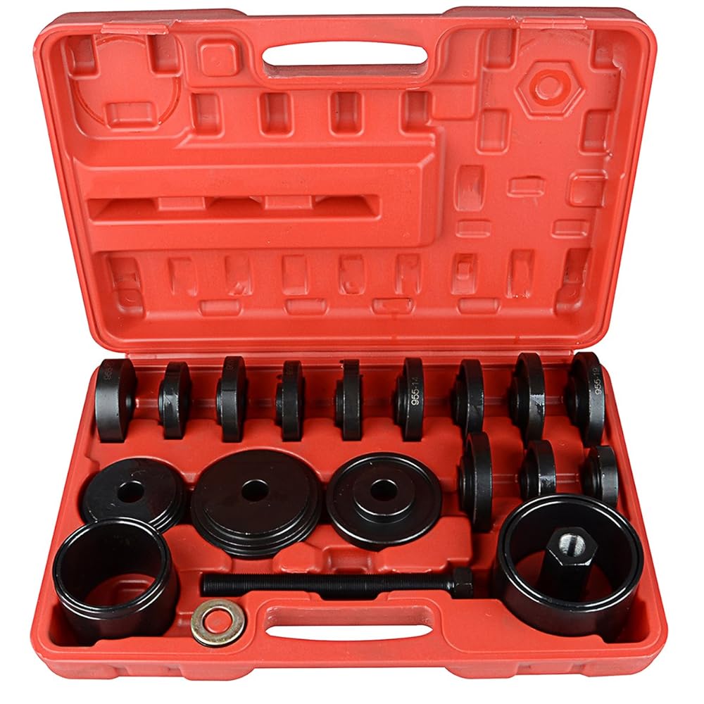

Tonnes of info. on this task over at https://xoutpost.com/bmw-sav-forums/x5- ... g-r-r.html
And yeah, you're going to need quite a few special tools, including something like this...
