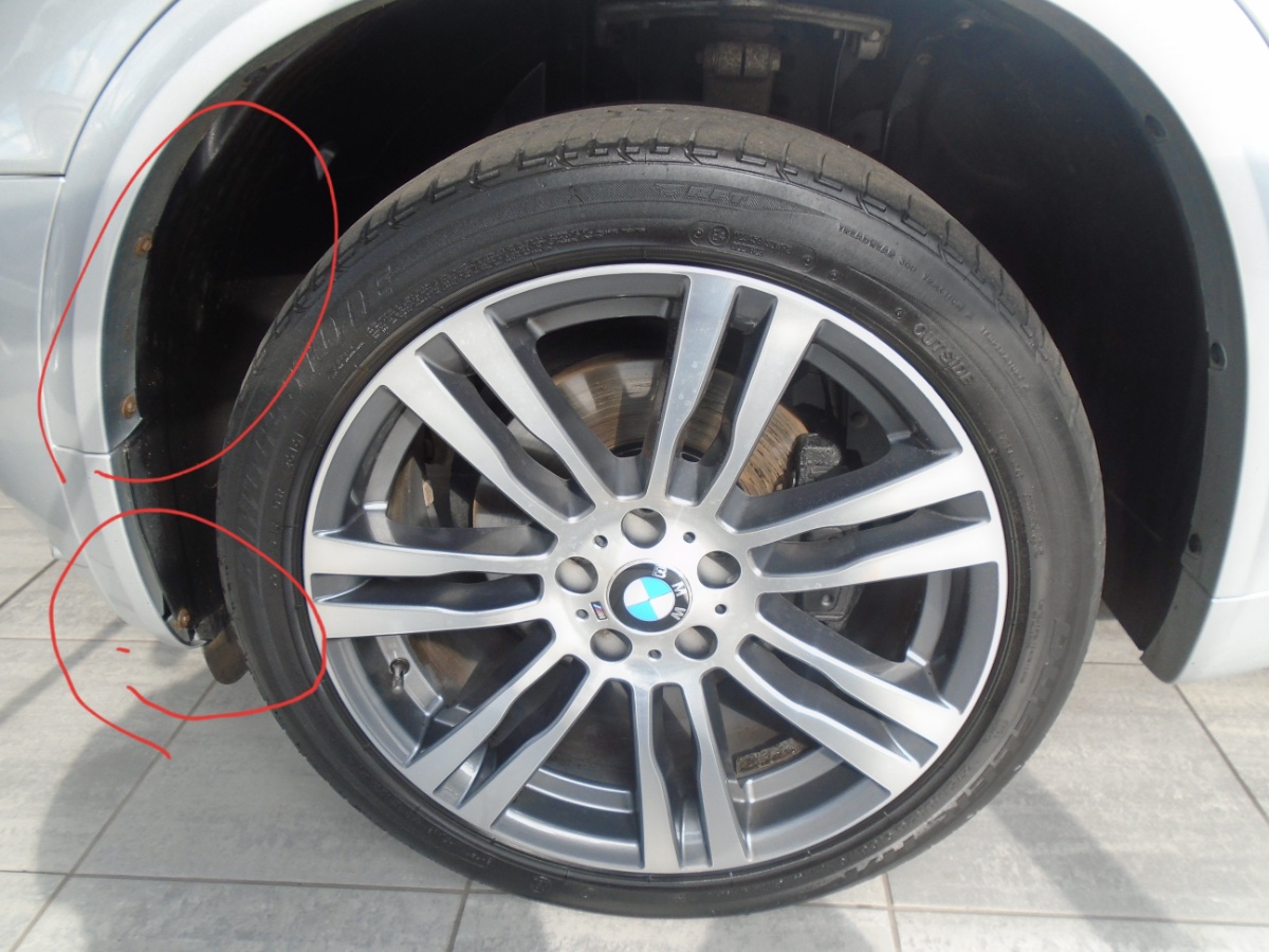

I've been sent pictures of all 4 wheels on a car i'm looking at, however one of the pictures raised a question in my mind as the bolt / nuts that hold the arch seal in place seem to have rust and a black plastic piece also out of place maybe. Both items circled in red.
Could those who are in the know take a look and let me know if this is an issue, anything to worry about or normal. Unfortunately because the pictures were sent focus on the wheels, i don't have context if these are front or rear.

On my car these are held on with a kind of black plastic rivet and not steel bolts. You require to remove these when taking the bumper off so have a good look for a reason for the bumper being off. Other than that you can buy the push in rivets on ebay for a couple of quid a pack.

Sorry just realised this is the front wheel. I answered without my specs on. My wife is away out in the car just now so cannot check for you.

Someone has had the bumper off and buggerd up the rivets.....front bumper or arch liner needs removing for various things inc to just fix the pop up light washers, so I wouldnt worry to much.

Rivets like the other side of the arch as said , do not buy the ebay ones the heads snap of before they tighten up I found and you need a plastic rivet gun to fit them .

To be honest I bought the ones you pry the centre pin and head out and they can be reused, no requirement for rivet gun, just push in.

I think I'd agree with above comment around its prob been removed for other work and not put back properly.
