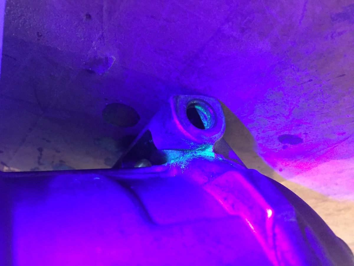

by henrym3
This is the sort of small leak that shows up under uv
