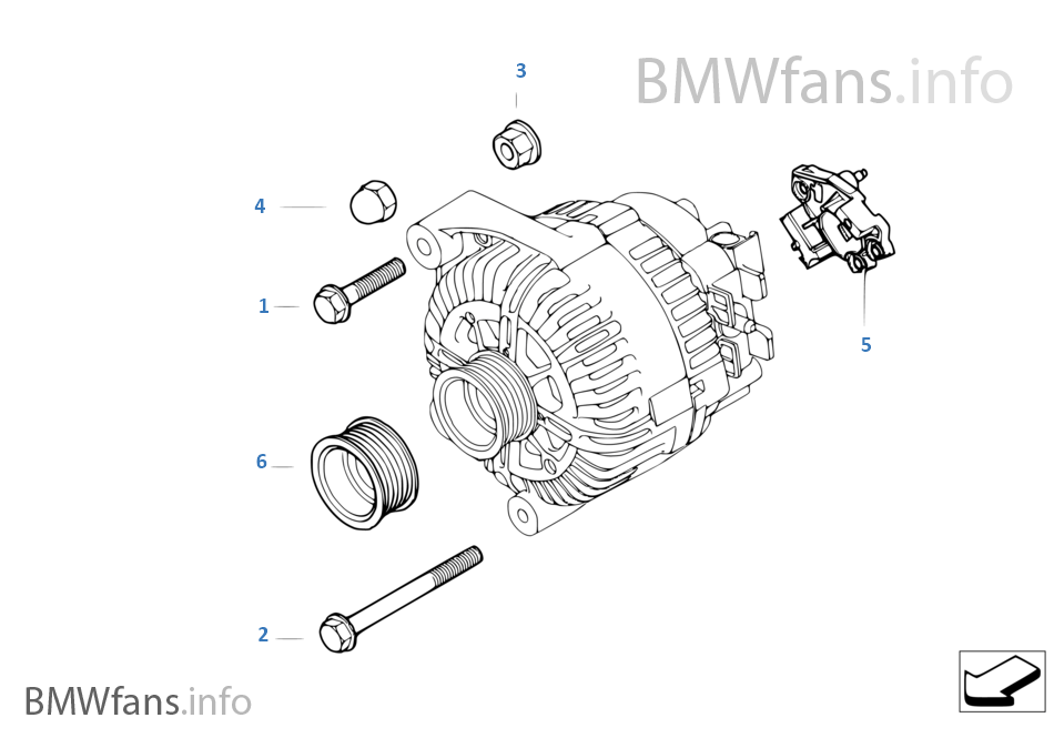

The voltage regulator is item 5 on your alternator and yes it regulates the alternator output. The one for my water cooled alternator was £28. The YUASA battery I have fitted is 100Ah and the usual 019 which fits our vehicles. Been in a couple of years, no problems yet.
Remember I’m showing a pic of your regulator I’m not saying that is your problem,

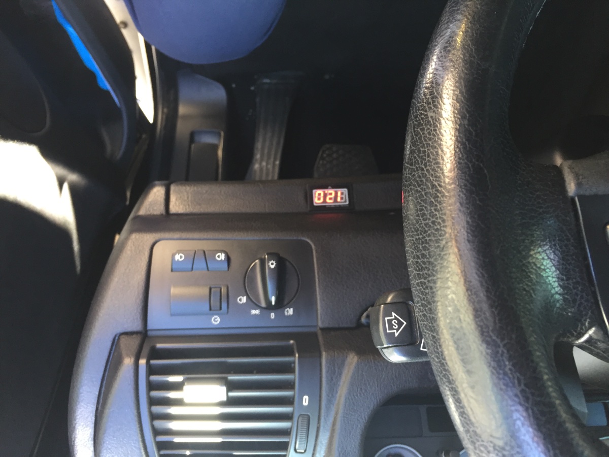

I found that even when my previous battery was coming to the end of life the alternator still pumped in 13.8/14v the battery just couldn’t hold it for long. Nowadays I mainly do short runs but just been to Ireland and irrespective of distance or load I am always between 13.8/14v. I can say this with some confidence because of the item fitted in picture

Thanks to everyone for their replies. Yes I suspect it is the battery. What is the gizmo you have fitted, do tell?

I have a similar thing in my e53 up by the map lights but it also has 2 usb ports 1 i use for my dash cam.(i didn't fit the cover)
