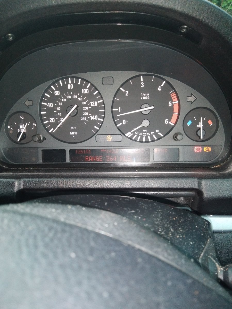

Hiya guys ive searched and searched and only come up with what ive done. Basically my issue is ive had e53 3LD sport 2005. Been sweet as for last few months the odd three lights come up DSC 4x4.abs But turn engine off and Bk on gone for a few more days now. Everytime after i drove over a cobbled roundabout. Lost drive stopes turened engine off Bk on drove but errors.now I drive 4x4 abs and a red light pops up left side of abs. Car feels like its holding Bk only rear wheel drive chamged tyres to new cost wnough. From what ive read it all points to the transmition actualtor. Sooo.... bought new cog fitted same issue. Now im thinking the actual actuator motor is gone. As diagnostics showing tramition somit. Im litarlly pulling what little hair I have left out. As its only real wheel drive. Not sure how to.add pics

We need the actual error.  It could be the steering angle sensor that has an issue.  That is known to bring the trifecta (three warning lights) on rather than it being a transmission issue.
If it is showing a transmission error code, then what code? Need the error code number and error text (description) if you have it.

Abs light 4x4 light and a red light with what I can only describe as a semicircle each side and a ! In the middle
