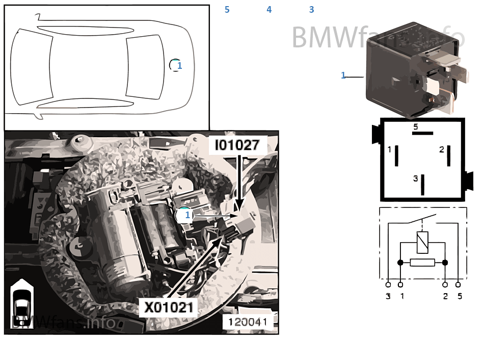

Thanks I'll get new fuses on my next day off and which relay is it for the suspension?
Thanks
Posts: 1948
Re: Bmw x5 4.8is (2005) inactive suspension
Post by henrym3 » Sat Jun 15, 2019 3:57 pm
Parts list shows it in with the compressor. This is a 4.6 pic though

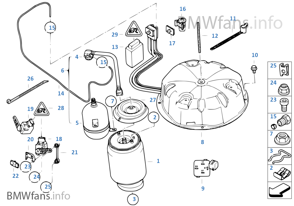

Posts: 1948
Post by henrym3 » Fri Jul 19, 2019 1:46 pm
Part 19 is the level sensor ( 37 14 6 755 045 ) and seems to fit either side and is common with all e53 except the 4.6ltr
Posts: 1948
Post by henrym3 » Fri Jul 19, 2019 1:51 pm
To amend my last post That p/n was for left side. 37 14 6 754 921 Is for right side :oops: :oops:
Tariq1980
Posts: 8
Joined: Thu Mar 14, 2019 9:46 am
Post by Tariq1980 » Fri Jul 19, 2019 8:47 pm
So are the level sensors and solenoid valve the same thing
Posts: 1948
Post by henrym3 » Fri Jul 19, 2019 9:04 pm
I’m not aware of any solenoid valves, perhaps that is what your diagnostics tool is calling it. Mine calls it a level sensor. I’ve looked through the parts list and don’t see any references to solenoids, As your tool says "rear left" that would imply that there is one on each corner, so I suspect it is referring to the level sensor. Just my opinion.
