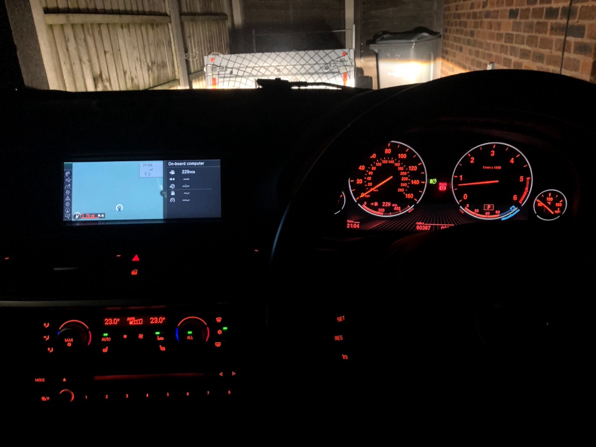

My X3 30d came with the 6.5” screen and Bluetooth but no satnav.
I have recently fitted a satnav headunit with the 8.8” screen at the same time I decided to fit the half led instrument cluster 6wa.
It is a doable job but can be hair pulling at time.
Happy with the end results
