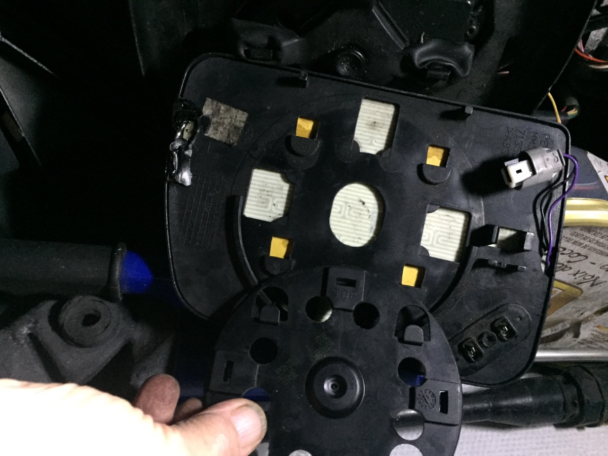

Post by henrym3 » Mon Mar 25, 2019 7:12 pm
This pic shows how the mirror backing plate attaches to the motor for movement. The center circular piece and the four legs (for want of a better word) pop into place to hold it. Perhaps some of them have popped out

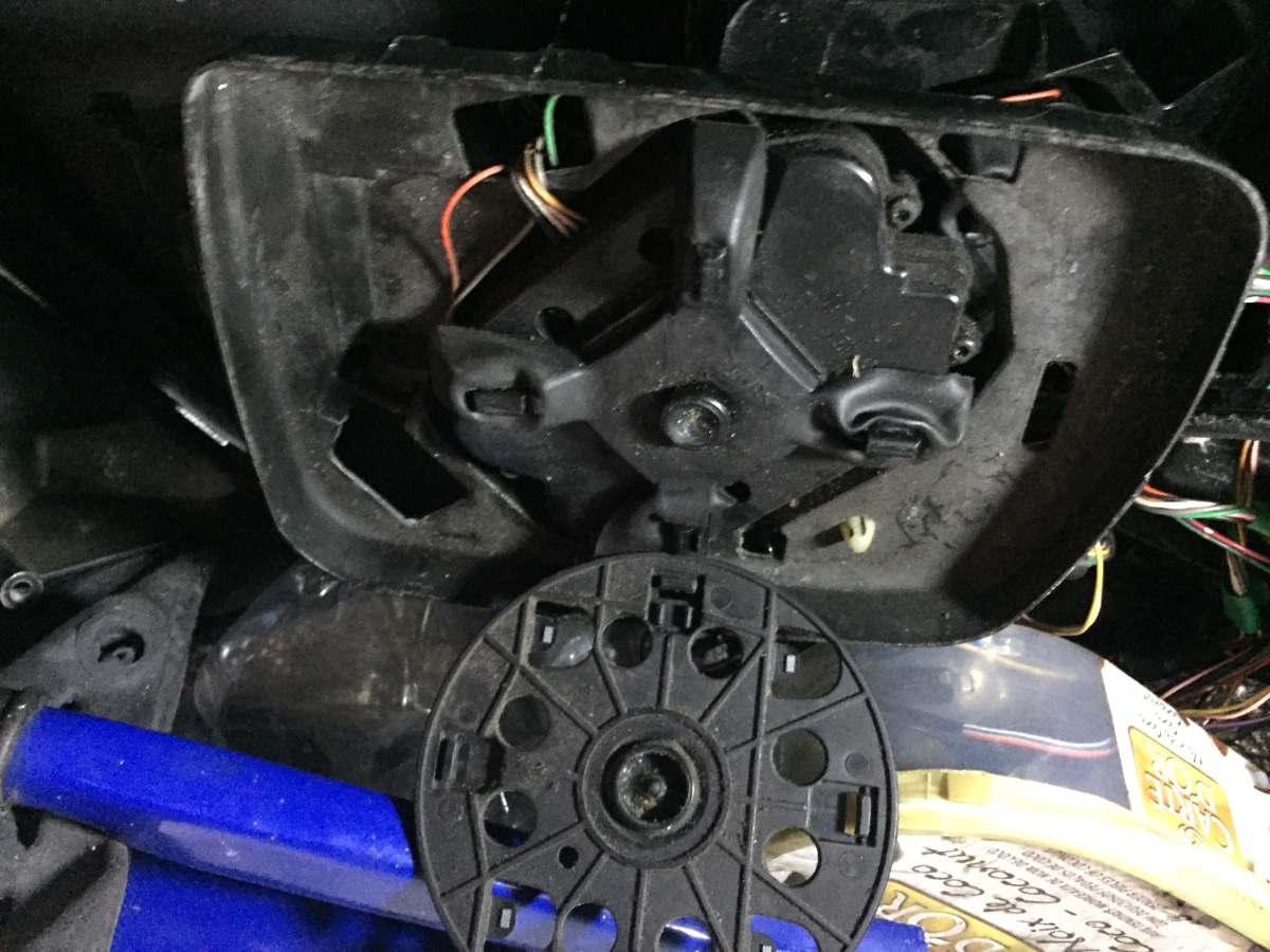

Post by henrym3 » Mon Mar 25, 2019 7:16 pm
This shows the other side of the circular plate which has the mirror attached
