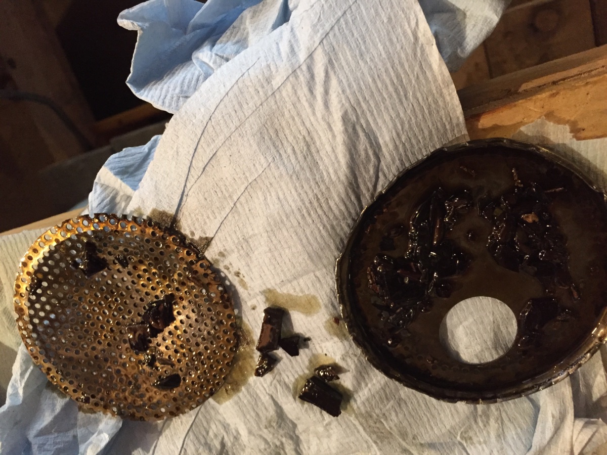

I changed the guides on my sons 4.4 which was making a horrendous noise at 105k and had actually broken some bits of alloy of the inside of the covers. I considered him the luckiest person in the world that the chain hadn’t jumped any teeth. Mine were done a few k ago at 145k. No noise or running issues, discovered because I had taken the sump off and there was plastic guide bits in the sump. My thoughts are if you get to 100k/10 years do it as a precaution. I know that’s easy to say if you can do it yourself for £500 and that includes other bits that you will find wrong. When you’re paying someone £1500 then it’s a different decision.

I did a write up ages ago about a full engine rebuild on my 4.6 after the guides collapsed completely blocking the oil pump suction filter up, which the original mechanic doing the guide change missed.
I think that the pictures have disappeared as the hosting site required a subscription.
So if you ever do have bits missing from the guides, take the sump off and check the suction filter....

Good advice this was mine, wasn’t even making a noise

If you drop the sump you will definitely see the bits of guide if they are gone. Once they break off they have a pretty straight passage down to the sump.
