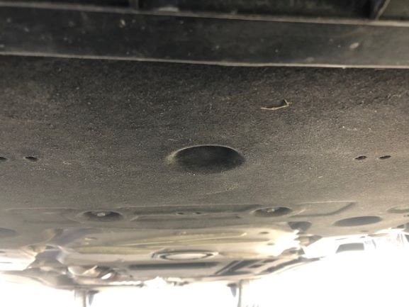

Hello can someone confirm the front jack lifting point on my M50D, is it the circle in-between the 2 x holes as in image?
Many Thanks,

Thanks, I am aware if these, but wish to jack the whole front end up in one go. I beleive there is a front end single jacking point.

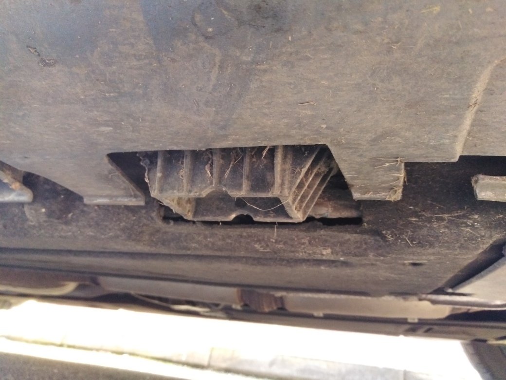

From what HenryM3 found (on your other thread about same) it is in the middle of the rectangular area just beyond the circular depression in your image. If you have a circular hard rubber (or similar) pad you can put between the car and jack (safely) that should help.

Many thanks found it, and jacked up car with no problems.
