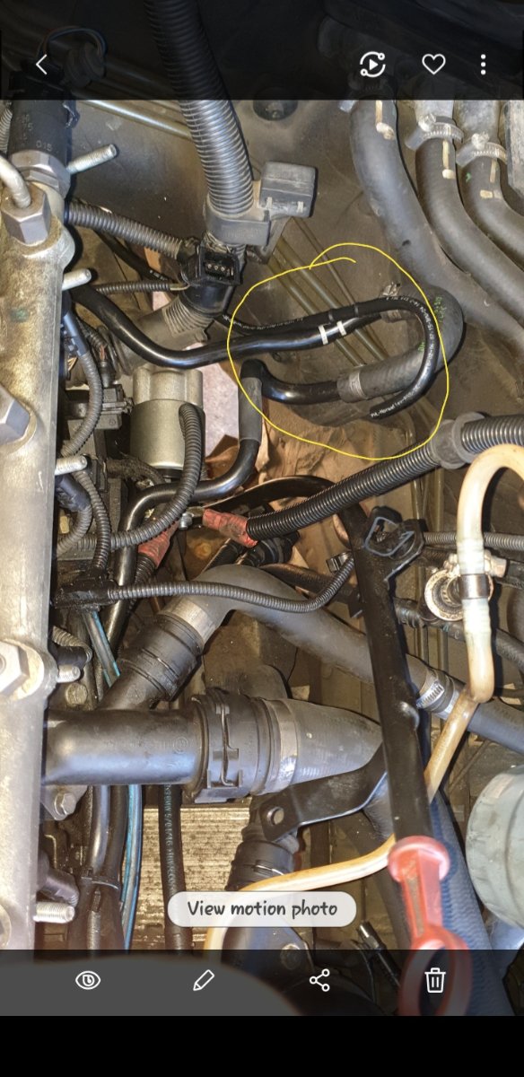

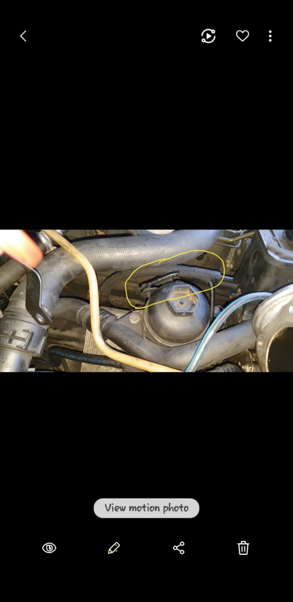

Had another look with covers off and found these two pipes connected to fresh air! One go's back to the gearbox and the other as far as I can see go's down to the front axle and comes up to the what looks like an oil filter? Could either of these be the problem? I also got my wife to rev the car and I could here a whooshing from the turbo area not sure if it was from the waste gate or not
- Posts: 19207
Re: Severe lack of power!
Front diff gas vent and probably the gearbox gas vent pipes.
