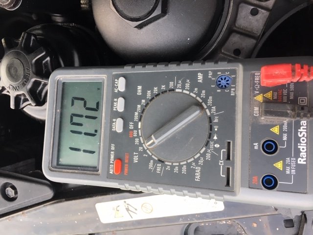

Locked the car and thought all was good, then about 7 hours later the alarm went off, checked the voltage again and it had dropped to 11.72v, is that enough of a drain to trigger the alarm?

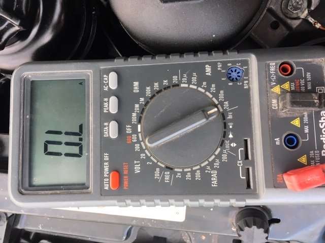

Meter set on amps and switched to 20A on the dial connected it across the under bonnet terminals and it read OL, does this mean it's drawing a lot of current and the meter is out of the settings range or am I reading it wrong.

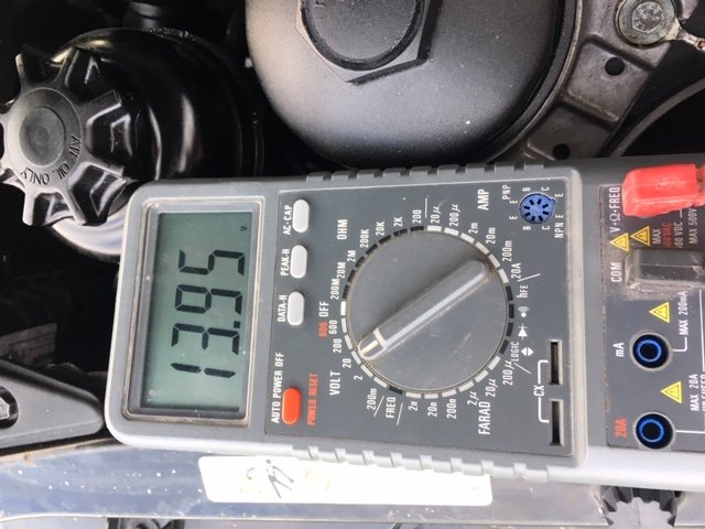

I then thought I'd see if the battery was getting charged when running, meter reading 13.9v when car just ticking over, I think that's ok.

Fully charged and with the car asleep you should be seeing at least 12.6V. You will need to leave it for 4-5 hours after last use/charging before you measure it. A brand new, fully charged battery could show as much as 12.8V (AGM Type). I measure under the bonnet so leave the bonnet open enough to avoid the alarm switch and just lock the car.
Anything below 12V with the car asleep indicates at least one dead or dying cell. My X6 battery died without warning a couple of weeks back. It was falling to 11.5V after a couple of days without use. That one was 8 years old.

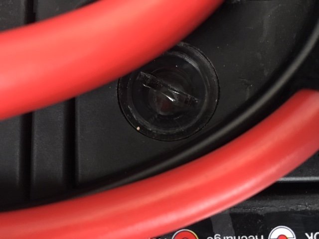

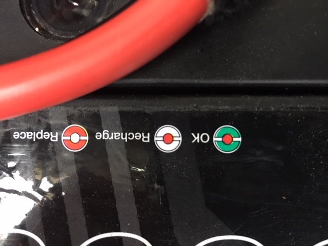

No date on battery, but I did see that the indicator is saying it needs recharging, I'll add a couple of pics to show.
I still can't get my head around the reading when I measured any current draw.

If the car is awake it could be drawing more than 20A. Mine draws >60A without the engine running. You need the car asleep, and use a current clamp device (measures the magnetic field caused by current flow) to measure a current draw without disturbing the electrics or incinerating your meter

I think my first phone call in the morning is to the battery shop, lol.
I already have a price from BMW of £120, so I'll see what others are offering.

You can't measure current without breaking into the circuit so the the meter is inline unless you have a clamp meter which goes round the battery lead ,if you put it across Id say the fuse should be blown or your meter would be on fire as you are shorting out the battery unless I've picked it up wrong ?

You are right, the correct way of measuring current is to break into the circuit or use a clamp meter, basic schoolboy error on my behalf.
