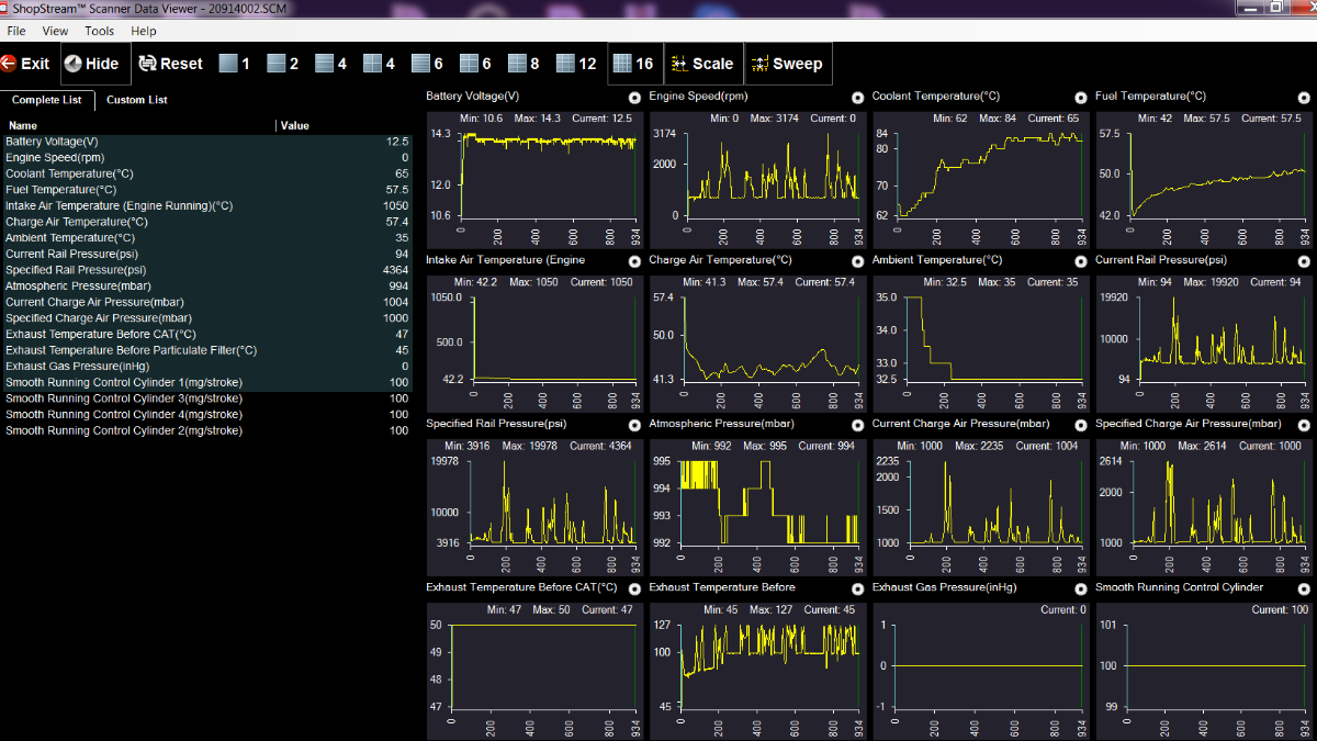

Attached are engine data graphs while the poor acceleration, black smoke is happening.

If the MAF has gone faulty then the engine computer will be getting bad data. That could cause over-fuelling or incorrect mixture leaving to smoke.
Glowplug 5 has failed and needs replacing - needs doing with great care as my X6 needed 7 hours of work to fix snapped glowplugs just last week. If you are doing them then it’s a good idea to change the preheater controller at the same time,
Fuel system has a pre-heater to stop the diesel fuel ‘waxing’ in low air temps. The fault code suggests that has failed as well. This would cause fuel starvation.
- Posts: 1747
Re: BMW X5 2008 3.0TD: Reduced Boost on Acceleration and unburnt Diesel out of exhaust
Can you just unplug the airflow meter on these like you could on a 330d and see how it goes ? couldn't run any worse by the sound of it ...

I’ve had very similar symptoms on my 08 3.0D and it was due to over boost because of a sticking turbo wastegate. Although that chucked a fault code for overboost too.

The MAF reading looks way over as its over 1050C , MAF readings should be +/- 2C of the ambient temperature, I presume you live in a warm country, so as the ambient temp is 35C it shoud be reading 33 to 37C for the intake temp.
