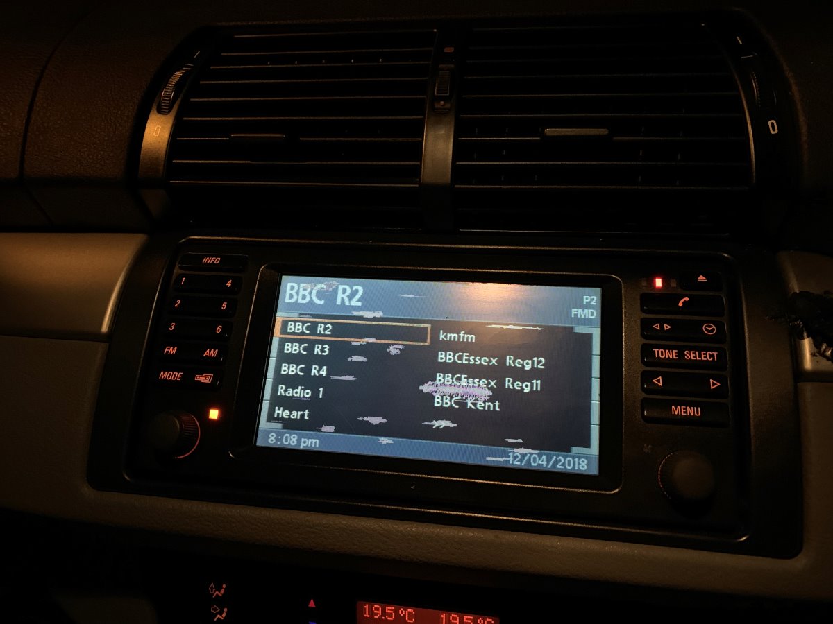

Can anybody tell me if this is a mkIII or mkIV navigation in my E53 please? I going to attempt to get rid of those ridiculous marks all over it until I can get a Dynavin unit (second in line to an exhaust of course :wink: )

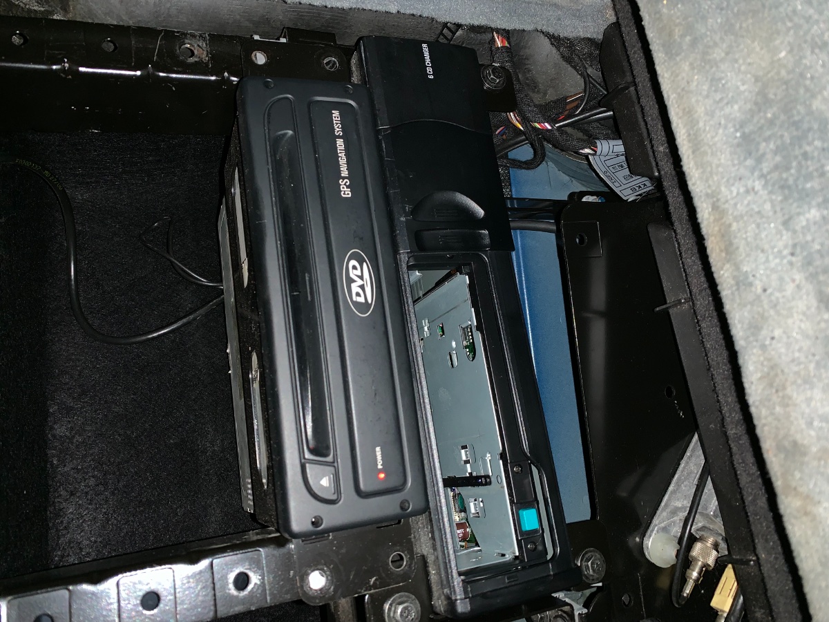

Mk4 head and if your boot mounted have computer says DVD then it’s a Mk4 system.
What happened to the display? Is it on the surface or in the panel itself?

Excellent thanks. I’ve only had the car for a couple of weeks and it was like that when I got it. I think it’s in the panel and there’s probably not much I can do with it but I’ll strip it down and see what I can find. The patches don’t move when you touch the screen and they’re always in the same place so probably fatal.
This is what I have in the back

The marks on the screen are dead pixels and nothing to with the sat nav unit...happened on my old e53...had to replace with another unit from ebay...if you change it make sure you disconnect the battery...brown off 1st and back on last...

Not that I’ve done it but isn’t this the sort of thing that people have fixed with what they call the ribbon repair

henrym3 wrote: Tue Dec 18, 2018 12:15 am Not that I’ve done it but isn’t this the sort of thing that people have fixed with what they call the ribbon repair
I’m hoping that’s all it is. I’ll give it a go and see what happens. Nothing to loose really.
