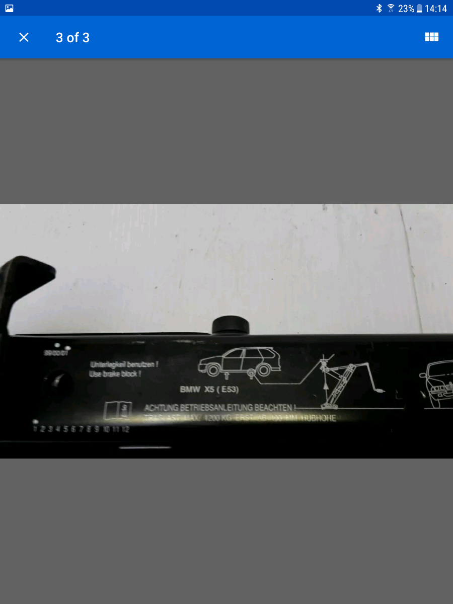

Post by sapphireblack » Sat Nov 24, 2018 11:18 am
Any reason not to carry one, car weight is similar. E53 jack less invasive to space and easy to operate.

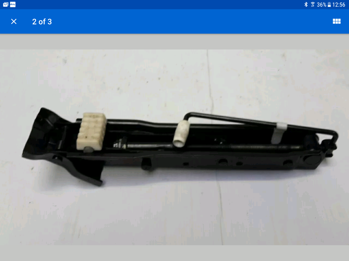

TBH, i hadnt thought to check part numbers but E70/71 are scissor type and bulky. My E53 had this type.

Might have been revised or replaced? Mine had a scissor. Could be worth checking the part number in Realoem to see what it was from. Looks like the one in our E46 - which probably also fits other models too.

Post by sapphireblack » Sat Nov 24, 2018 2:19 pm
Maybe they were changed, my car was early 2001. I've asked the seller for a part number but this suggests compatibility.

Post by Leslie » Sat Nov 24, 2018 6:00 pm
Mine is scissor type , i wouldn't be keen to use that other type had 2 fail on an e46 seemed to be near its limit on that car never mind a heavy x5/x6 though I guess the x5 one is a bit more sturdy. The lifting part is nylon and can't cope with any sideways movement or it will snap although the second time it just folded up ,gave a couple of creaks while winding it up and I stepped back as I guessed what was going to happen and down it crashed. :o
