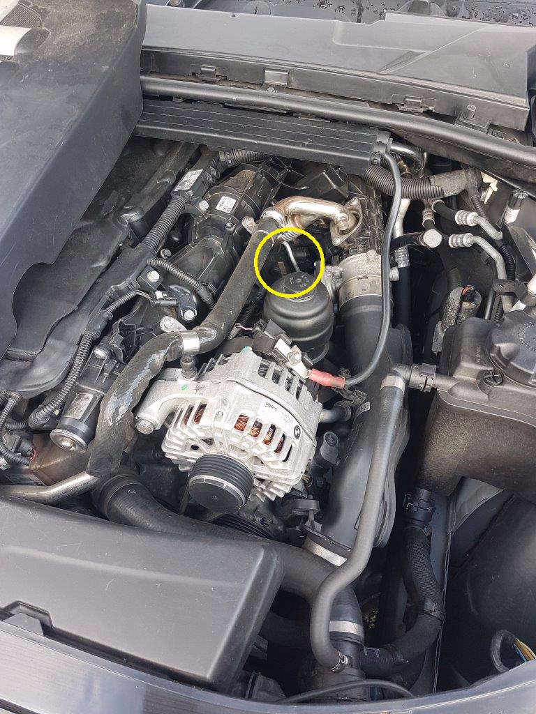

As it was sunny over the weekend I did the basic service on my X5 (oil + all filters) and was very happy to discover that the glow plug controller (which I need to change) is actually reachable without removing many parts (picture below was taken from another forum). Question I have is if you need to disconnect battery when replacing it? Anyone else did it on the N57 engine in their X5? Anything else I need to do in order to change it?

Yes disconnect battery, your lucky on my X6 35d you have to remove the intake manifold

Thank you. So that's a nice "little" job for Saturday

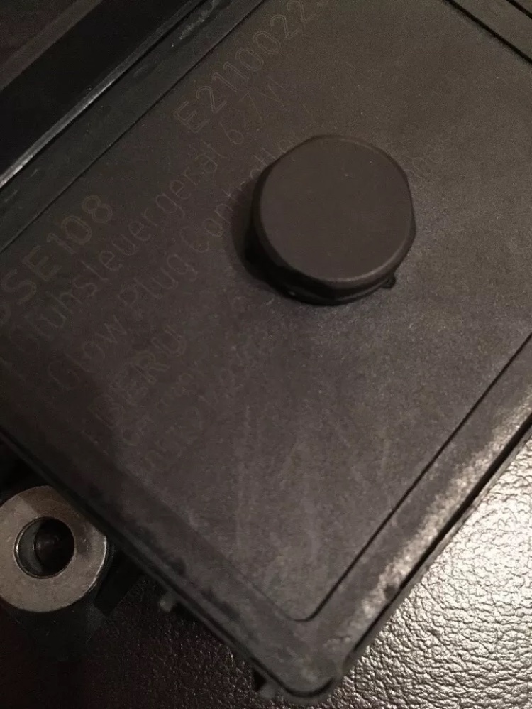

I didn't manage to do it this weekend as the controller that I've order was used and I bought a new one. Contacted the seller on eBay and they are going to send a new one out. Hoping to do it next weekend.AdamsX5 wrote: Mon Nov 26, 2018 8:43 pm How the Saturday job go?
Got mine booked in dealers for diagnostics and then repair under warranty if covered. Excess is £250.
Other option is to drive to Doncaster and let seller dealer repair it FOC but the hassle and I will pay for diagnostics anyway to prove the fault as they will say glow plugs are fine. My car is not doing regen because if this and it will soon clog up the dpf as you need a working controller.
Can’t even force regen.
Pic below shows what I've received last Thursday - clearly not a new unit.

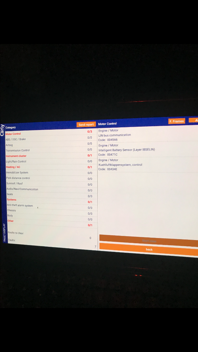

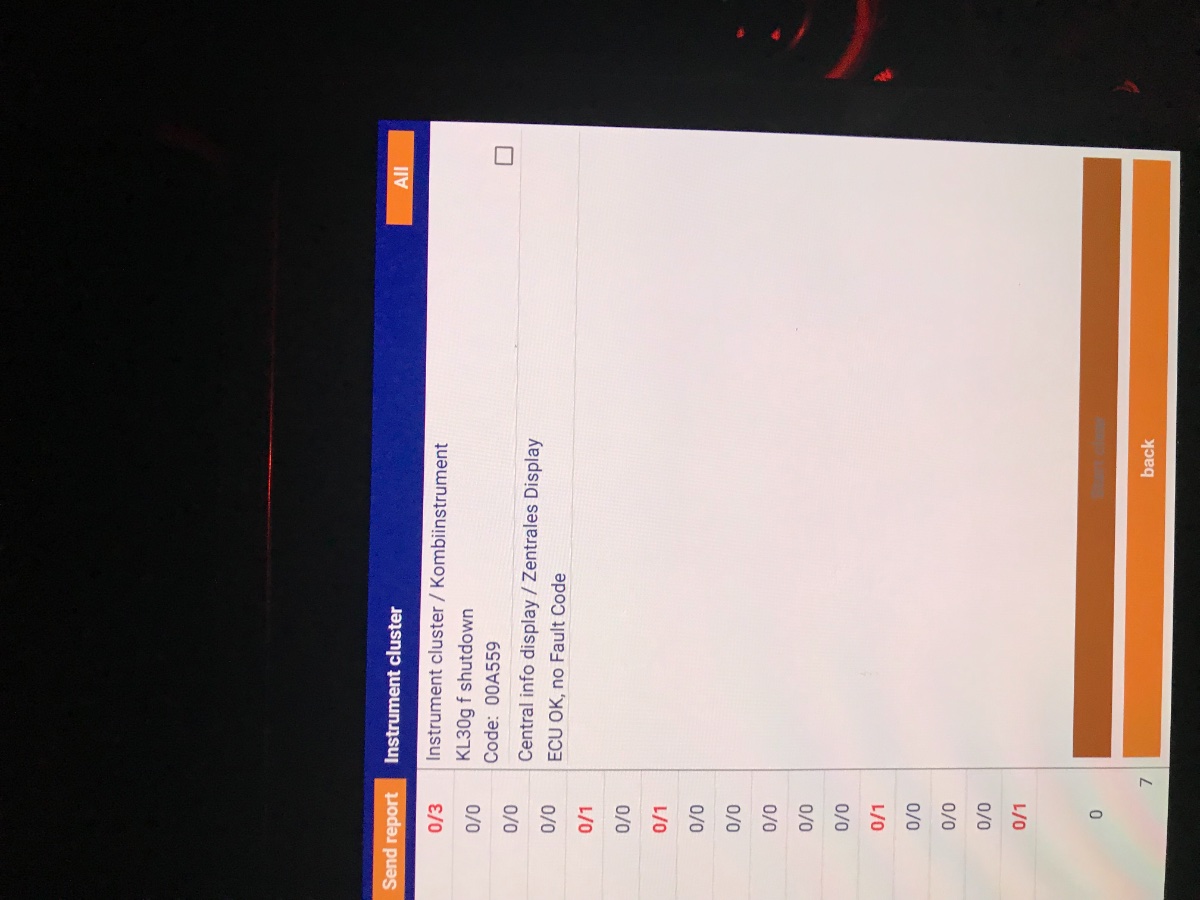

However me been very suspicious or cautious I did another read of faults. I have 5 faults but when I came out of dealership I now have 7.faults. ...2 more on the engine one for IBS sensor and another one attached below. So from a simple glow plug controller issue I now have the IBS sensor faulty???
If the warranty company denies claim I now have to prove dealership caused this.
The warranty company still pondering over whether to pay for it. They have said it’s a coveted component but want to know how and why it got faulty. Any repair costs to be uploaded to them via garage main dealer.
