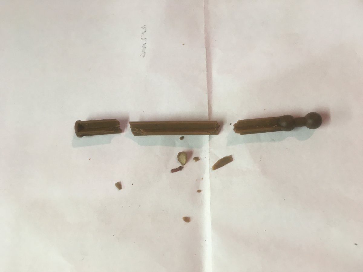

Not sure if this has been covered before but upon checking my coolant level at weekend as you do , removing the cap my floaty thing didnt pop up thats strange i thought hasnt been using coolant up to now adding coolant still didnt rise but yet i could see the coolant level now , whys the float not rising decide to remove coolant tank for a better look and found this slight problem
, only thing i can think is it must of broken up as i removed the cap as all the bits where in the coolant in the tank , glad i decided not to drain the whole coolant as all that would of gone into the engine , not sure what coolant should be in my engine as some say blue some say red but whats in there is a greeny yellow so i opted for what was already in there , so new tank and coolant flush this weekend long as parts arrive

I've thought it would be quite easy to trap the top of it down the side of the rad cap if its sticking up out of the water a long way and snap it as the cap is narrow at the bottom if its like the older style caps on e46 etc

They break up due to age / mileage and being brittle....next thing to happen would be a split in the expansion tank...so well caught.
