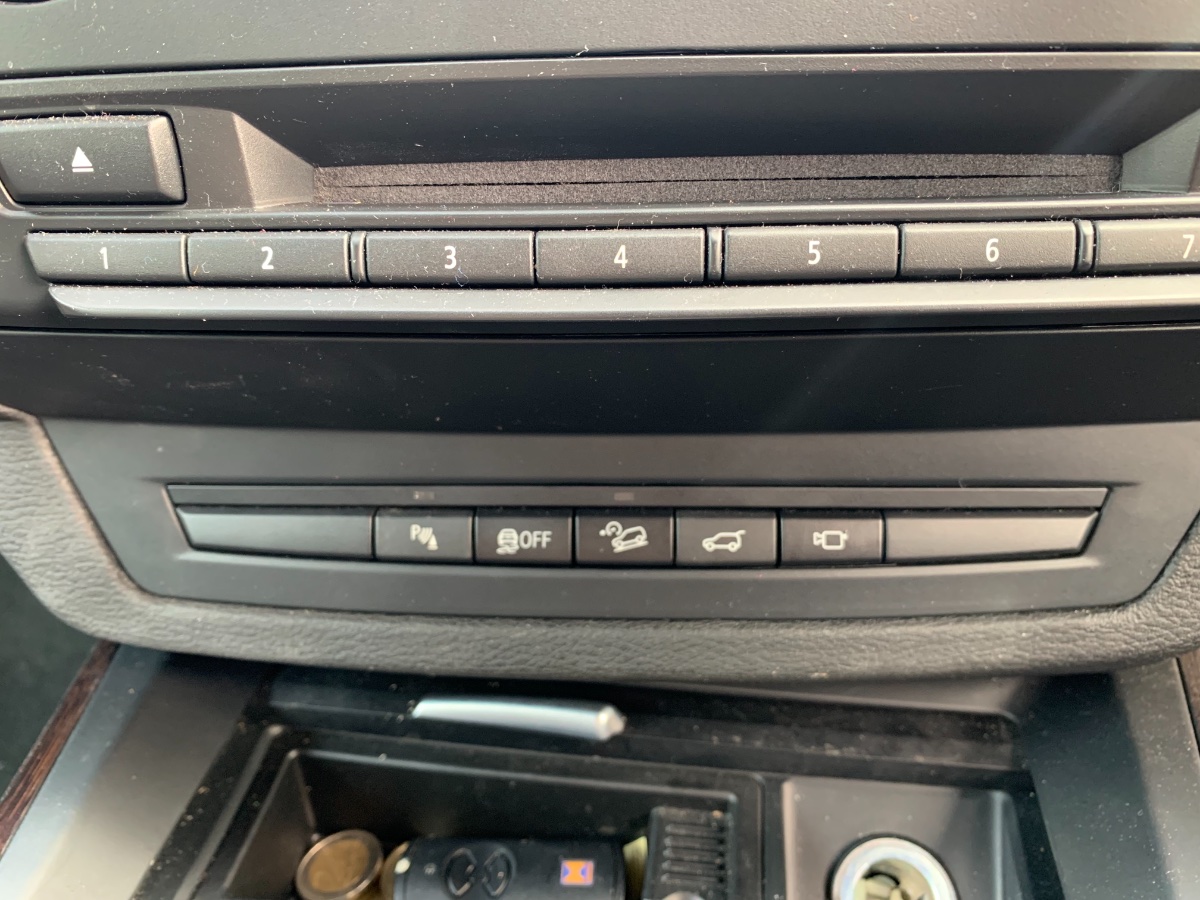

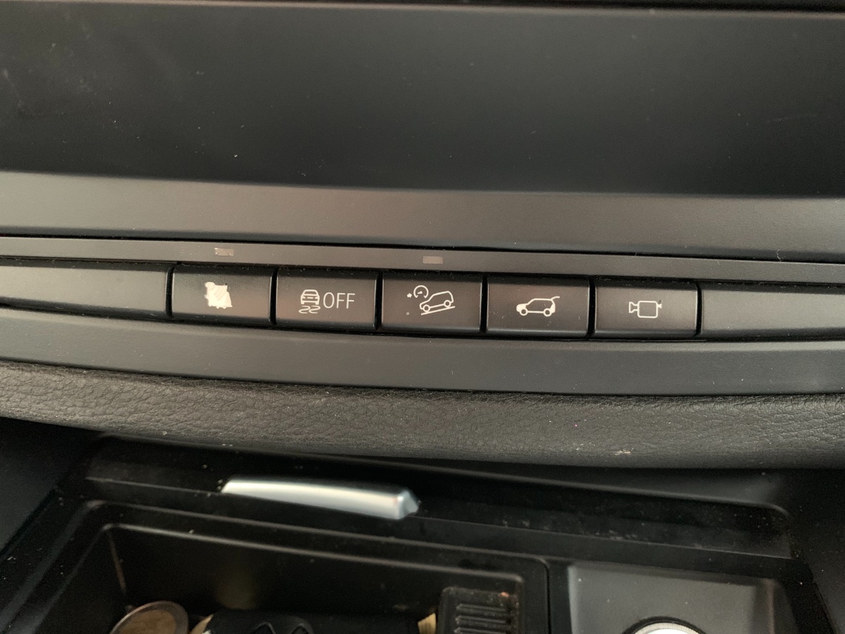

I picked up an E70 yesterday and the PDC button is a bit worn. It seems to be a fairly common issue as I noticed plenty of others on autotrader with the same.
Has anyone ever replaced them? Do you need a whole panel, or can you get a single button?
Worn Buttons

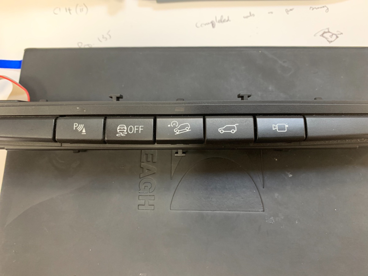

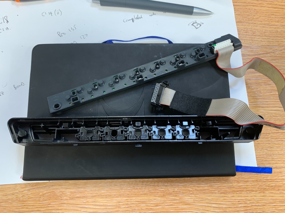

To follow up, I took my panel apart a couple of weeks ago and confirmed the buttons could be removed. I bought a replacement panel on eBay for £12 (non camera button) and took them both apart and swapped the pdc and boot release buttons.

was it an easy job? I could do with changing a few on mine.What's the camera button for? ive got rear and side cameras but haven't got that button

Re: Worn Buttons
Yes, if I can do it then honestly anyone can!
