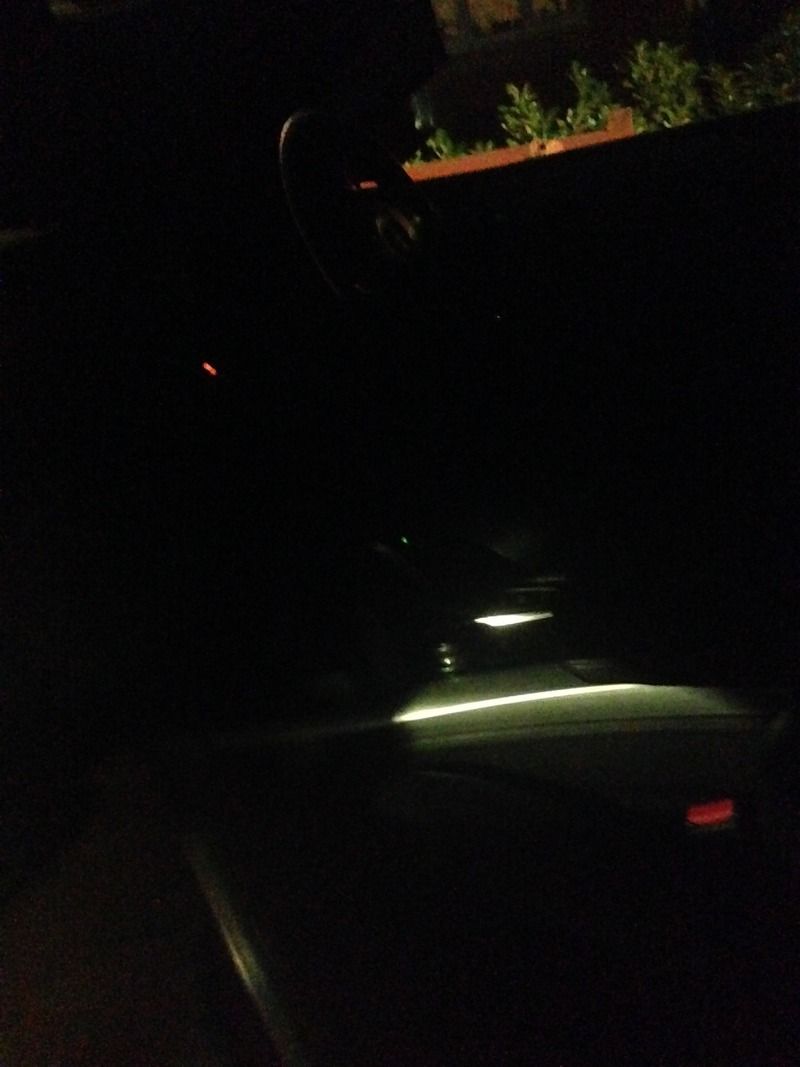

Post by celica » Tue Feb 16, 2016 9:42 pm
Start Stop Button and Gear lever P illumination when locked
Mine stays on, does yours power down?
celica
Re: Start Stop Button and Gear lever P illumination when locked
Post by celica » Tue Feb 16, 2016 9:51 pm
Can just about make out in pic
This is after several minutes car has been locked and switched off

How long does it take to power down these lights?
I checked after 10 minutes and were still on

celica
Post by celica » Wed Feb 17, 2016 10:20 pm
Noticed this evening after charging the battery for a few hours and switching it off the lights didn't illuminate after being switched off but before charging it did?
