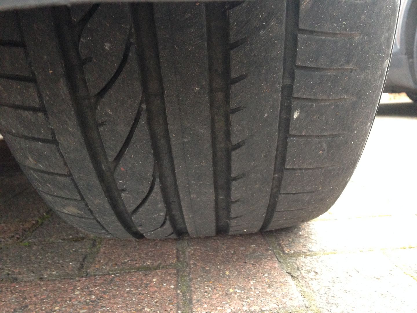

Perfectly good tyre but the outer shoulder on front near side has worn completely
Anyone else have this issue?
Would it be a MOT failure?
Pics to follow
Pics to follow

[/quote]Alignment could be out, we had the same issue with ours but we lost both front tyres through bad alignment.
The MOT spec is the middle 3/4 of the tread needs to be 1.6mm or above, the edges can actually be bald but you can't have and cords showing.

Characteristic of the car...........you wanted a good handling 4x4, there is your price !
The one to really look out for is the inner edge of the rear tyres
That isn't an MOT failure

i'll get the front suspension arms checked out and then tracked/ alignment done

As has been said above the geo seems to be out.
My guess is its got too much toe in on the fronts...
As the camber cant be adjusted.
The rears are a whole different thing, being adjustable for both camber and toe.....

That's normal. Mine went after 10K miles. Rears are fine. Ive had my car from new , but went and had the tracking checked. It was within spec. Asked the guy to tweek it a bit see if the next set last longer. Seems to me the E70 doesn't eat rear tyres like the E53 did , but it does like a front one.
That tyre wont be an MOT failure unless the layer beneath starts to show.

Had a hunter alignment done
Its in tolerance which I was surprised as it pulls to the left
Needing the toe adjusted but wasn't possible with the part seized up so getting new tie rod assembly's fitted
