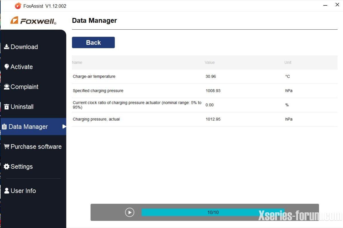

After spending around hour checking every data point that i could find the only thing that i could find that looked a bit strange in the charging pressure actuator. That was sat at 0% when according to the scanner should be within 5 - 95%. I don't know if it being at 0 is a issue as the car was at idle and cant find any info about the correct value at idle.

I've uploaded a 8 min drive with the live data. If anyone knows if the value should be a 5% minimum please let me know. As i cant find anything about the actual values any where. https://www.youtube.com/watch?v=B5hycZnbFFA

Bmw X1 2013 20d xdrive Automatic / Strange Noise and Sudden Low MPG
I'm no expert on these things, but it looks to me like it wants different boost "Specified charge pressure" to what it's getting "Charging pressure, actual". As the charging pressure actuator is barely registering, I'd be looking pressure-check the intake from the turbo to the inlet manifold to eliminate leaks, and if none found then replace the actuator.

Do the figures change at a fast idle?
The figures for the air pressure probably aren't far off. 'Standard' atmospheric pressure is 1013 hPa (mbar as was) so if the weather wasn't good then the 1008 could be barometric pressure on the day and the tubo is spinning slowly so only a slight increase. If nothing really changes when the engine speed increases then you're looking for leaks on all joints/pipes between the turbo and inlet manifold.

At fast idle it doesn't change much i noticed a jump to 17% for one second then back down to 0. It was raining and about 5c when i did the recording.

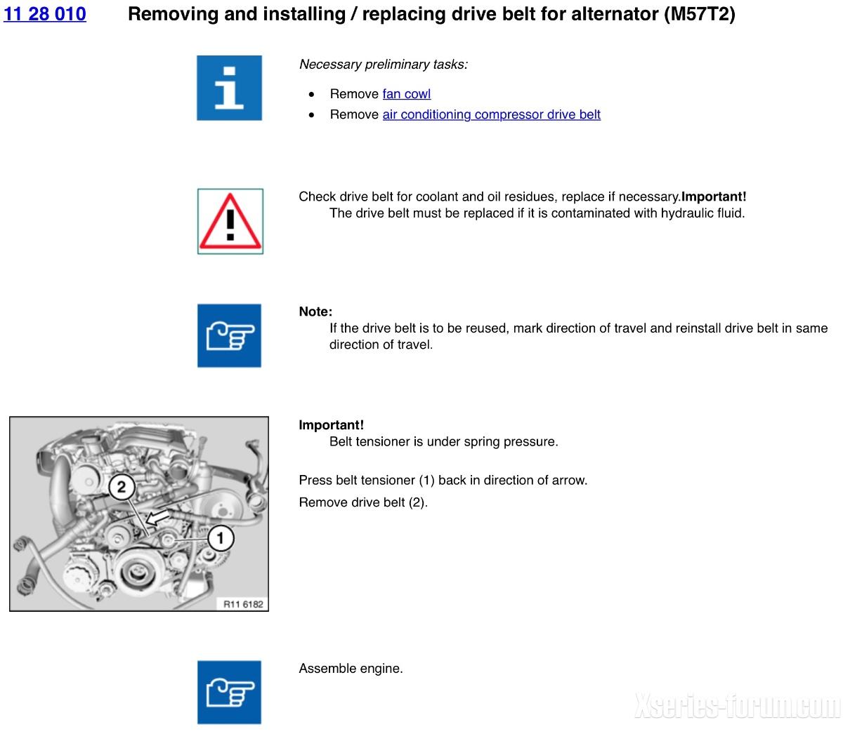

Belt tensioner … says you need to do this if you want to change the water pump. Hoping this might be the right engine/version. (M57?)
If the AC one also needs to come off that needs a special tool to put it back. Piece of cake really … not!

Thank youX5Sport wrote: Fri Feb 25, 2022 4:16 pm Belt tensioner … says you need to do this if you want to change the water pump. Hoping this might be the right engine/version. (M57?)
These modern aircon belts are "stretch belts " I just replaced on on our focus as it's in front of water pump/alternator belt like most nowadays.There is no adjuster on these and no way of taking the tension off , it just says cut it off ! (brilliant design ..not) You're right putting these on without the tool is a right faff it took me about 20 mins , the tool is little more than a spacer too allow the belt to ride over the grooves till it snaps on as you rotate the crank pulley . I used a piece of card on the grooves but with limited access it wasn't fun
