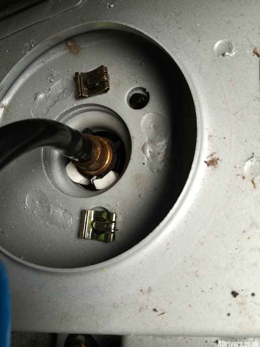

Right. The springs came in the post yesterday so last night I set about installation.
All ok until I started it up and it raised itself.. Then bang!
The connection to th top of the n/s bag blew off. Of course, the plastic holding clip dissappeared along with one of the sealing rings..
After searching around the back of the car and driveway I eventually found the clip but I had to salvage an o ring from one of the old bags.
Not sure why that happened but I put it back together and fashioned some spacers to prevent the clip from opening by itself (see photo). It pumped up ok and stayed level overnight so I've just put all the interior trim back in.
I have to say, the way the car drives now is totally different from before. It feels firmer and more planted on the road.

Great you got it all sorted. Nice on the spacers but not sure why it blew off and should stay on no issues normally.

No I don't know either. I did notice that the fittings were tighter on the original air bag spigot. After I connected the new ones up I tried pulling them off but were clipped on - albeit slightly looser.
Anyway, if they don't leak then we are ok..

Yeah agreed as long as they appear to b eon and not leaking then shouldn't be a problem. Can only assume it just wasn't quite seated properly there first time round. I have had that even with a genuine one where I thought it was on and as soon as it fired up it blew off.
