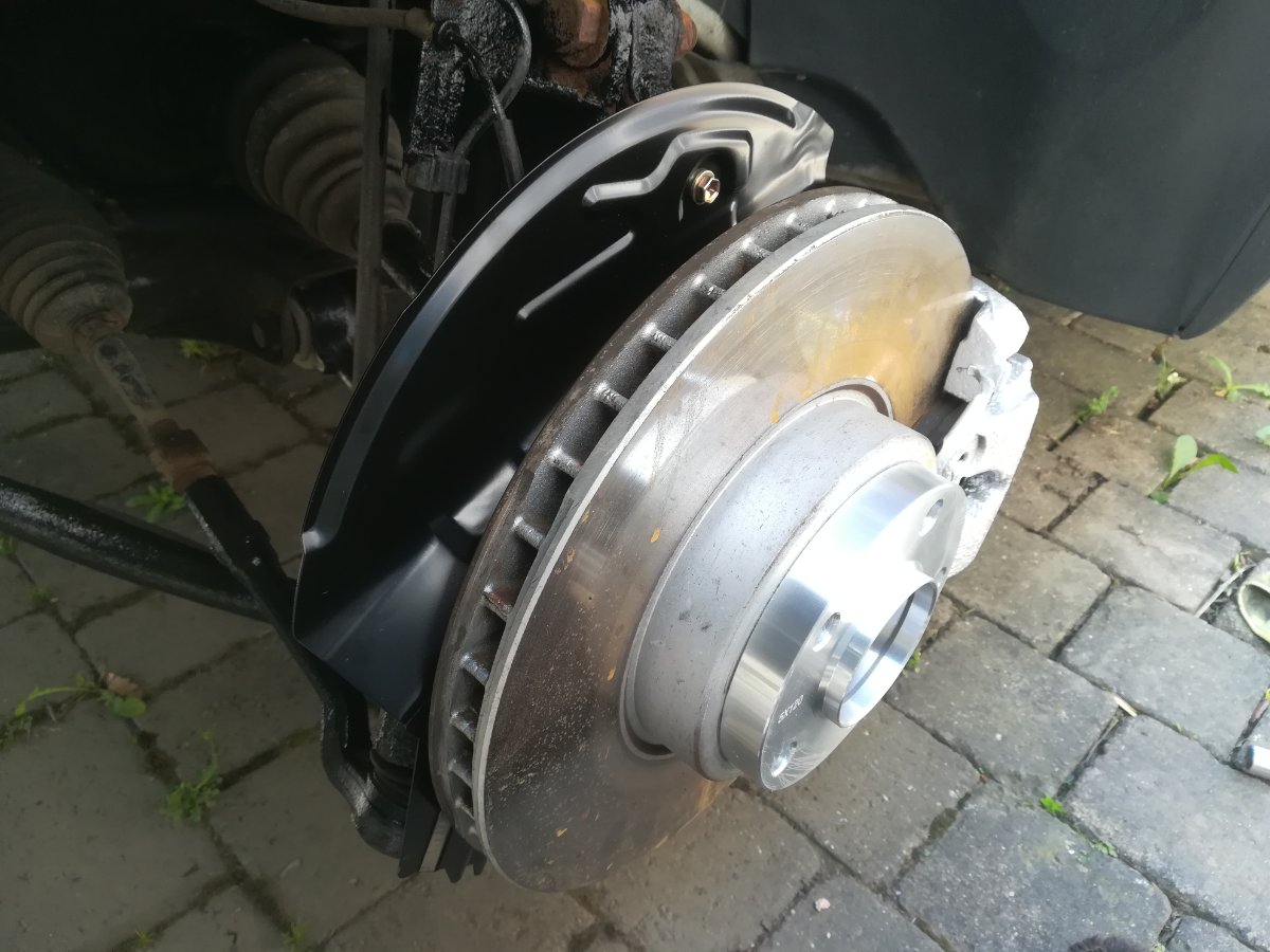

Backplate arrived. I put it all back together only to realise when I pulled the trolley jack out that I hadn't reconnected the brake pad wear sensor cable..
Not only that - it was trapped between the backplate and hub.. So everything had to come off again.

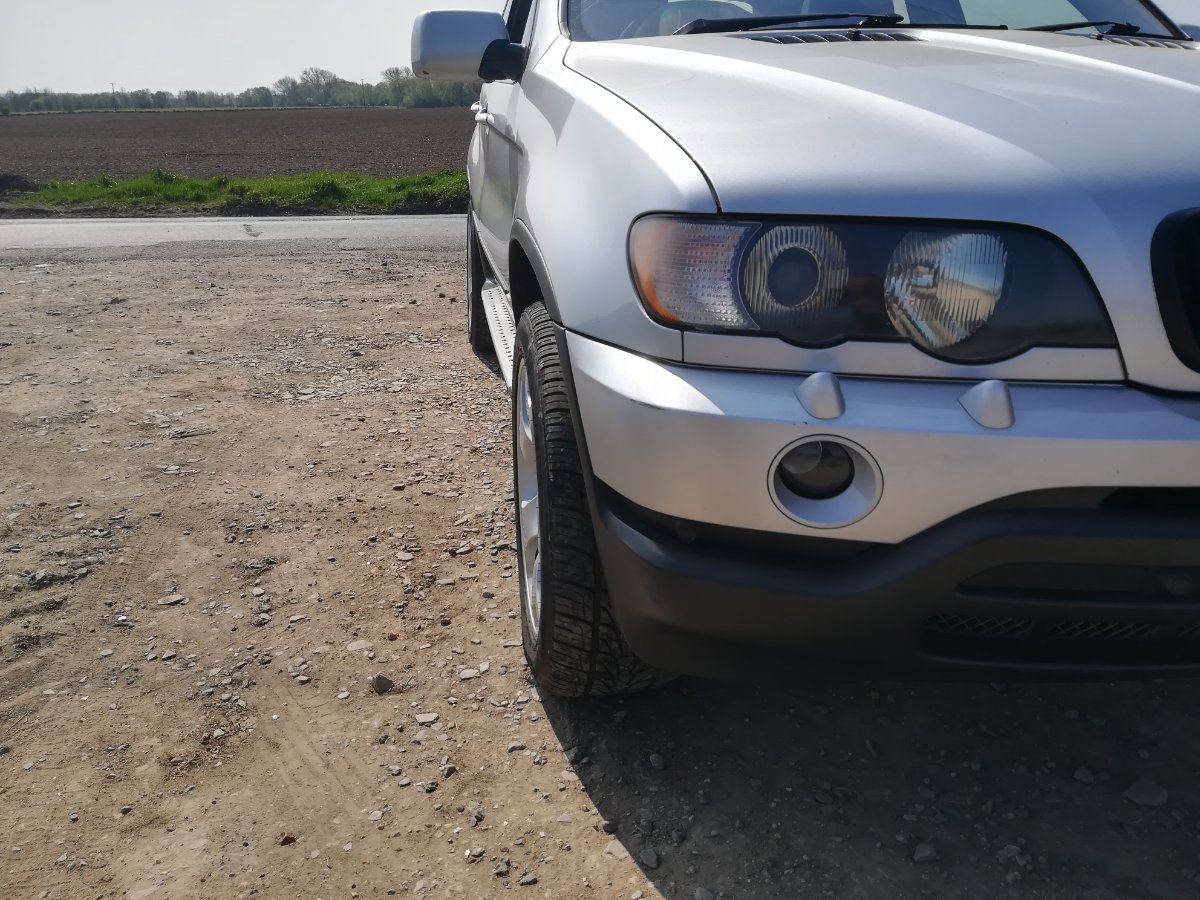

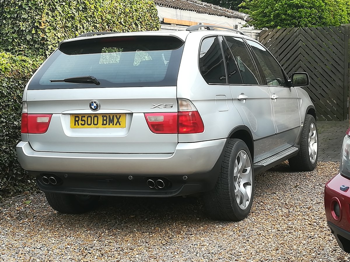

Looks a tidy old beast

I have to admit it is a pretty good one for 19yrs old. I've seen plenty over the last 3 years and mine has been the best still- even though others were a newer/less mileage and higher priced.
One of the wheels is a bit scabby so I think I may get them done in either original colour or a gun metal grey at some point.

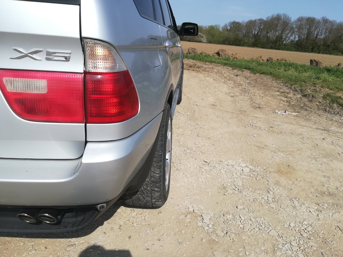

Mean machine..
