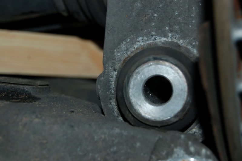

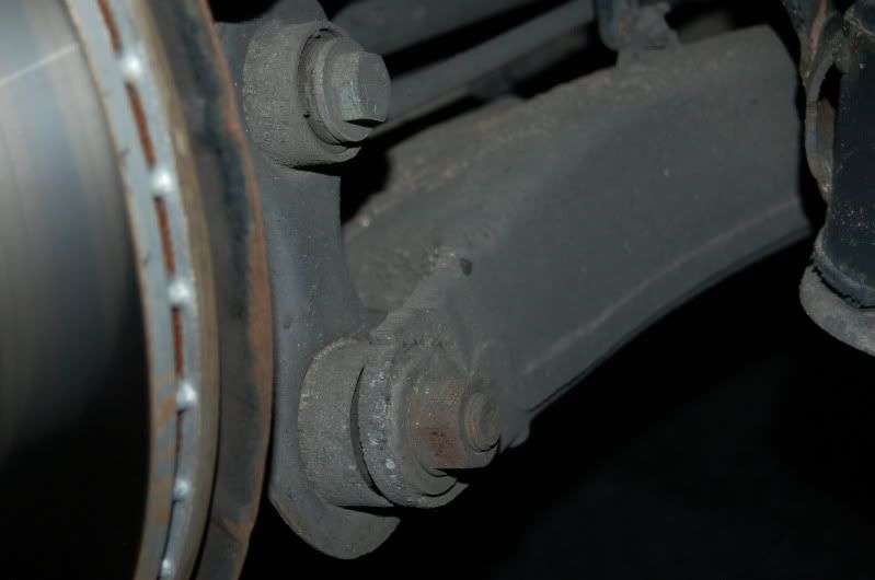

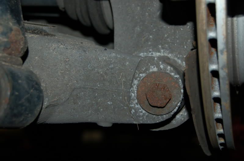

The nut at the bottom and the bolt at the top need to be removed:
This is the bolt from the other side:
Once the bolts, etc are removed the lower arm drops down to access the balljoint:

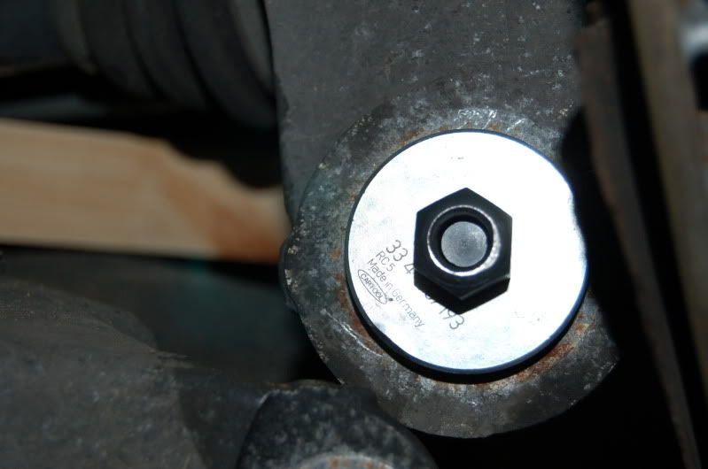

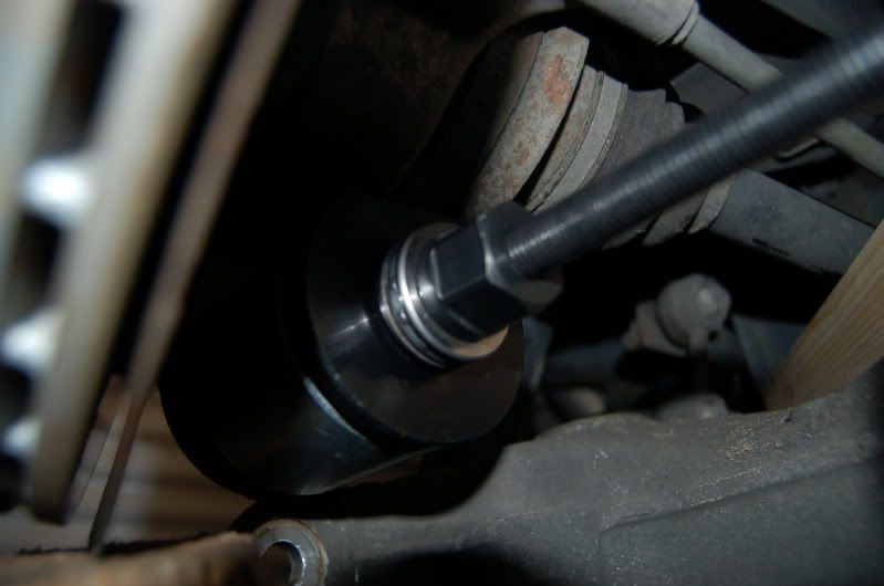

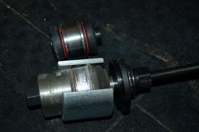

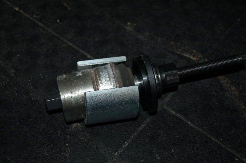

The BMW tool is placed over the end of the balljoint:
From the otherside:
Once removed (makes easy work of removal of the balljoint):
You use the tool from the otherside to pull the balljoint back into place and then bolt everything back together.

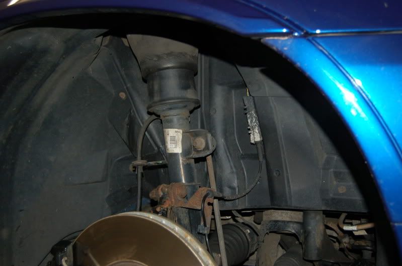

This is how the OSF looked to start with with a blown airbag:

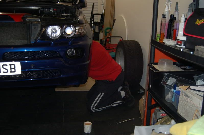

With the X jacked up I spent an hour trying to find the bloody wheel (then I realised it was behind me...lol):

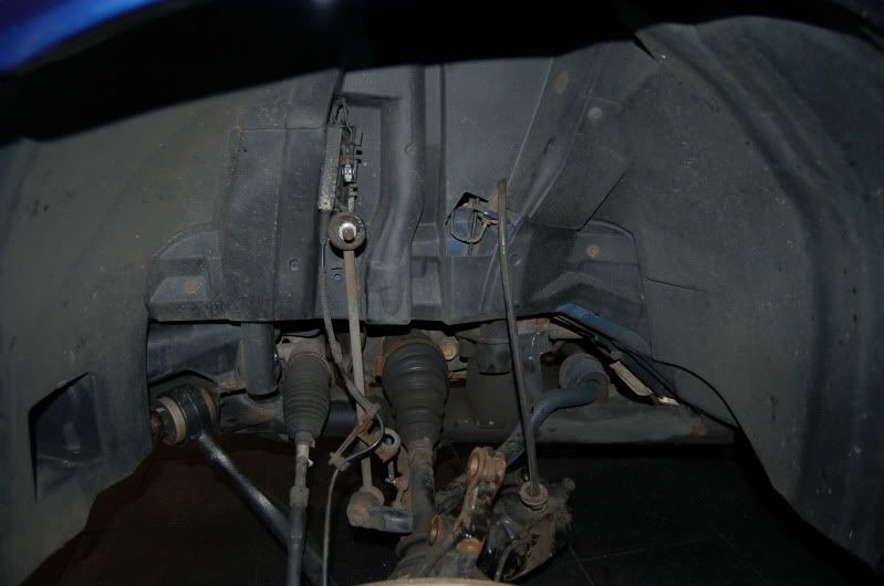

The old setup:
And finally removed:

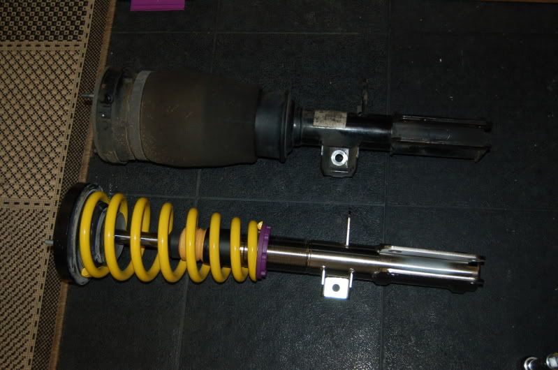

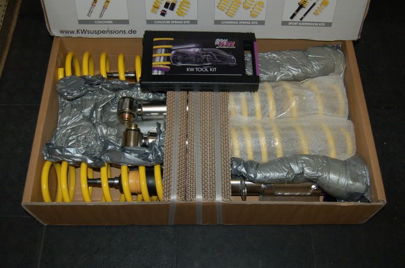

Always nice when you get a present to open:

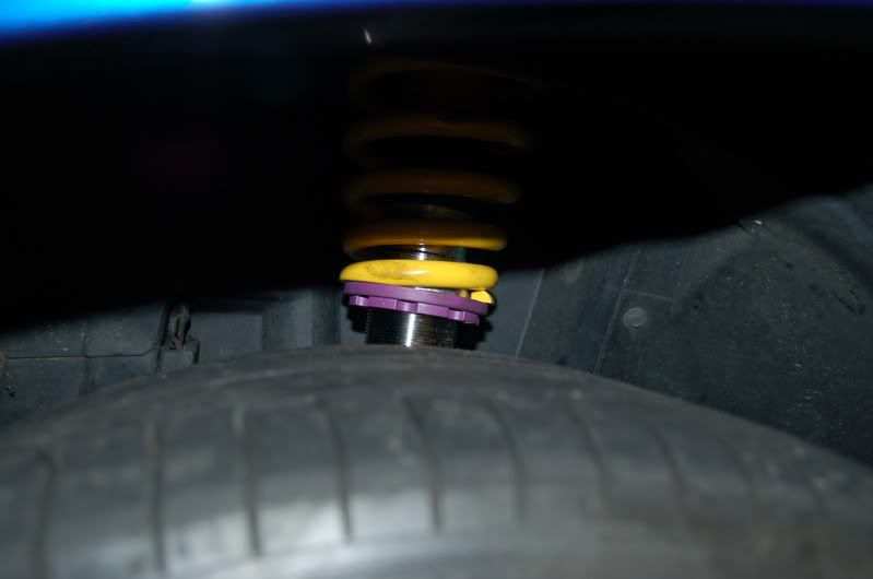

This is some serious kit. Fully adjustable, Height/Compression/Rebound:
Old with the new:
Front installed:

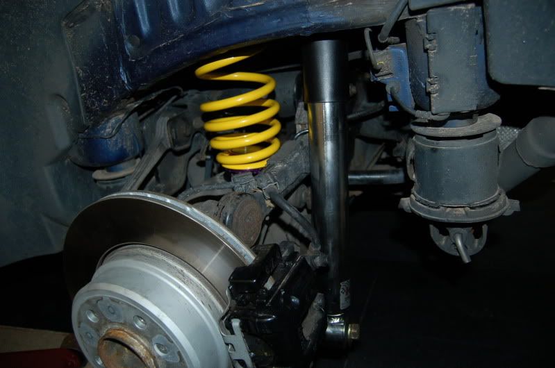

Now, onto the rear:

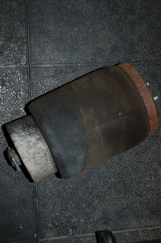

The rear airbag once removed:

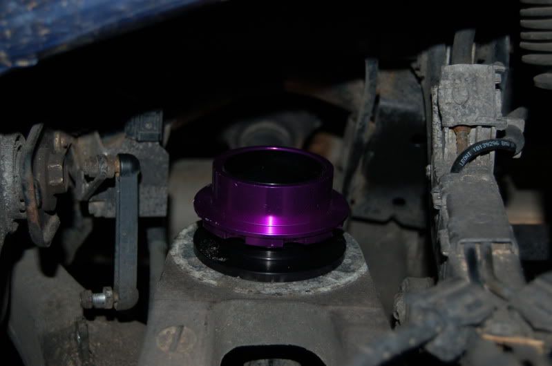

The rear adjustable spring perch:
All in and replaced:

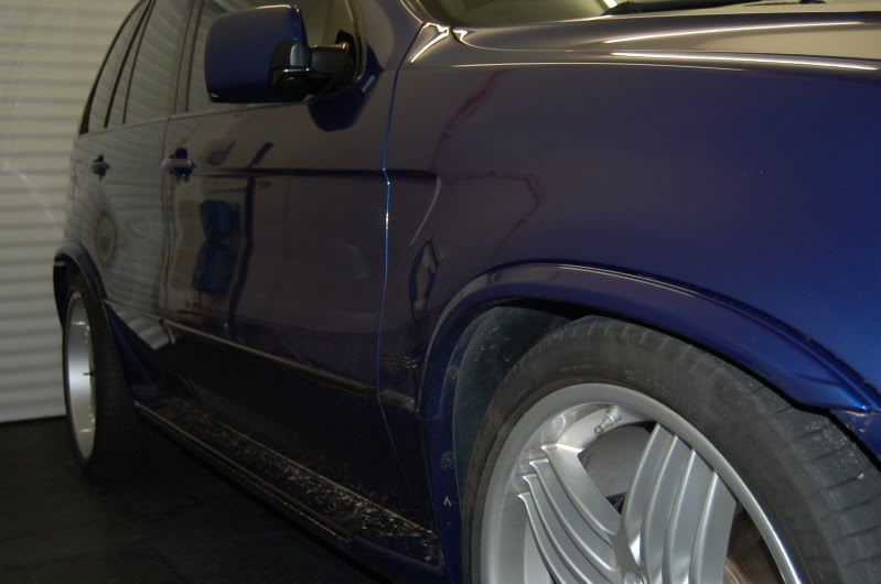

After a decent clean this is how the X looks (finally air suspension free):
May not look very low but it will settle further and tbh it is a a 4x4 at the end of the day.
It's basically sat where the lower air suspension setting would be, which is fine by me.

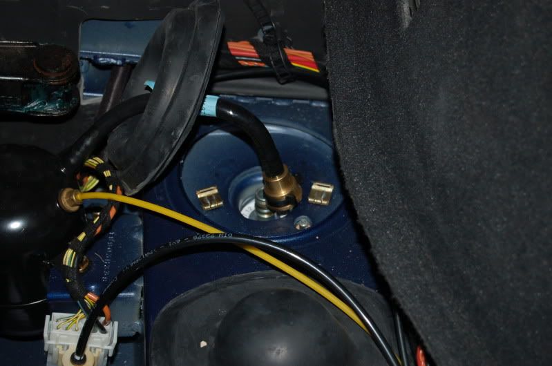

Just waiting for it to settle to get the levels just right before getting the alignment done. As for the compression/rebound, its only the rears that is a little more of a pain as the compression adjustment is still on the top so have to remove the trim, etc from boot floor to access. All other adjustments are straight forward though.
