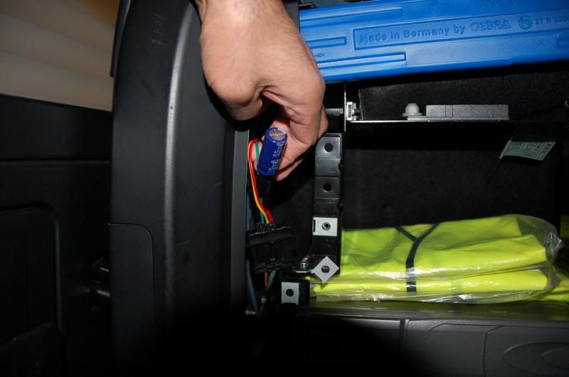

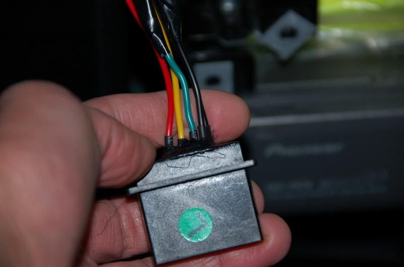

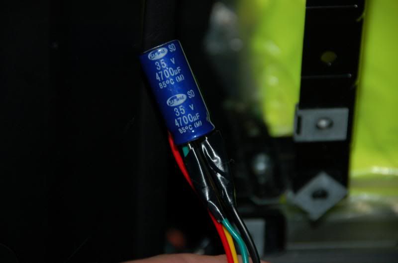

Soldering is straight forward but otherwise just use scotch locks but make sure you reveal bare wire for the scotch lock to grip onto.
You can see the green (positive) and 2 black wires (negatives so doesn't matter which you tap into).
MAKE SURE YOU GET THE RIGHT CONNECTION OFF THE CAPACITOR (as in positive side and negative) otherwise it will get hot and go pop.

I have not soldered anything since school! Should be interesting.... I don't suppose you have a link to a guide?
Sent from my GT-I9300 using Tapatalk
[/quote]

Thanks for the pics Raj
I reckon I can manage that!

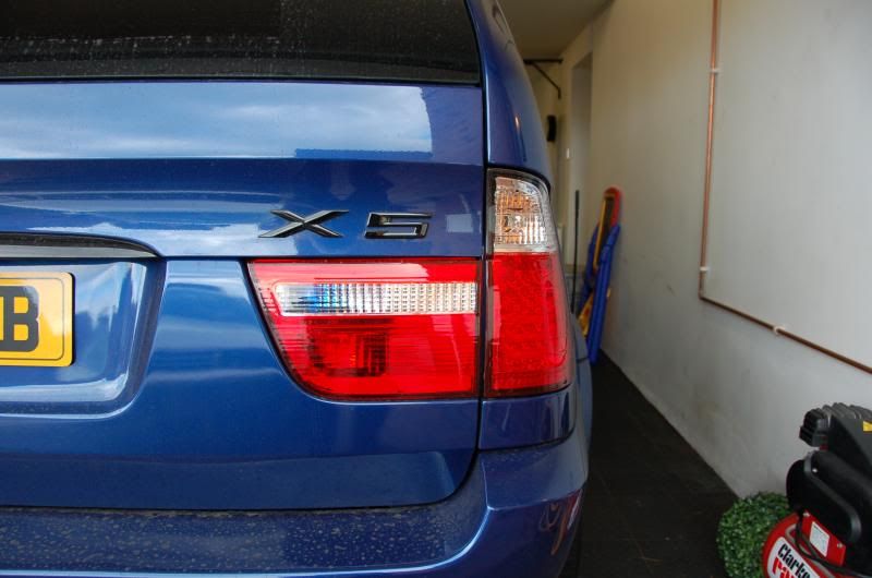

Hi Raj , time flys but i only got round to fitting those capacitors on monday , great job , no flicker now , thanks , Colin ..
