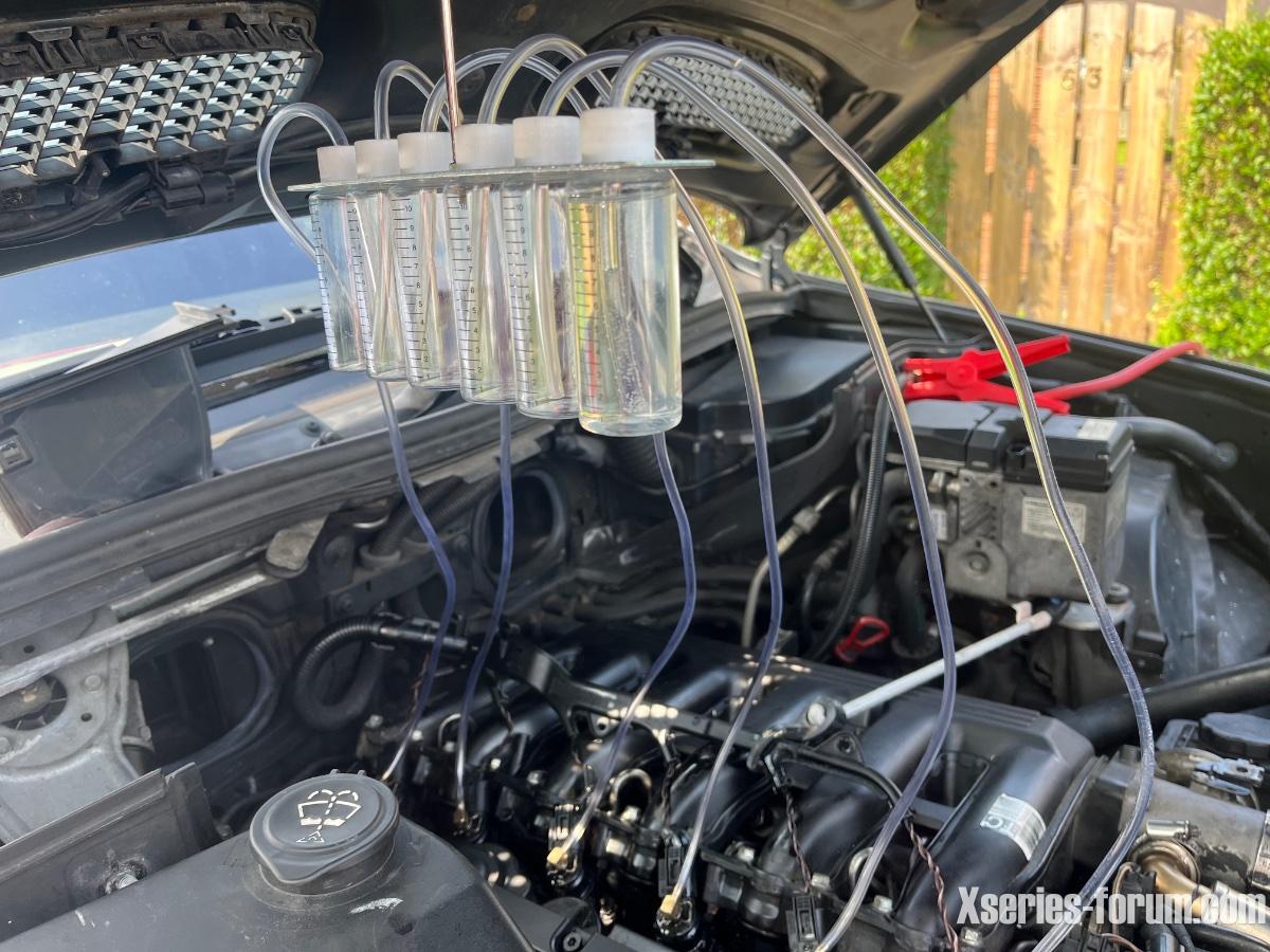

Now my question is. Would a stuck open injector cause this ? And is there any way I can test this even tho car won’t start ? Maybe a leak off set ? And go from there
Would just cranking be sufficient
Or can I disconnect each one and see if the levels increase on the rail
Any suggestions Would be welcome I’m at wits end

Seems that way leak off kit ordered..
Will just cranking it give me results ?
Posts: 1531
Car stalled, black smoke Fuel injection on dash
Post by Alan Gunn » Thu May 30, 2024 4:24 pm
If you have a good battery that will crank for 30 to 60 seconds.
I would think you will see a lot more fuel in 1 or 2 maybe more bottles.

Alan Gunn wrote: Thu May 30, 2024 4:24 pm If you have a good battery that will crank for 30 to 60 seconds.
Yeah I’ve just chucked my big battery on charge ready, might even go as far as chucking the cars one on charge when I get home from work, I think the second battery will be enough to crank it for 30/60 seconds

I think if you have some leaking you will see more fuel.
Thing the running test is 2 minutes but cranking foe 1 should show enough to see witch are bad if any.
Get somebody to do the cranking while you watch it might just spew out of one.

Sooooo…
This explains a lot 10 seconds of cranking and yup first bottle filled instantly
Posts: 1531
Post by Alan Gunn » Sat Jun 01, 2024 4:56 am
Glad you found it.
I will say no more lol.
Apart from it's handy that it is number 1 and not 6 easier to pull out.

! Explains the fuel pressure loss! And when I started having the issues the black smoke, injector clearly shit itself
Let’s hope when new injector arrives it’s all done

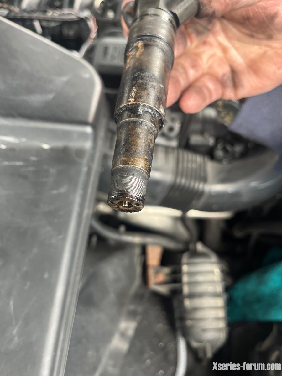

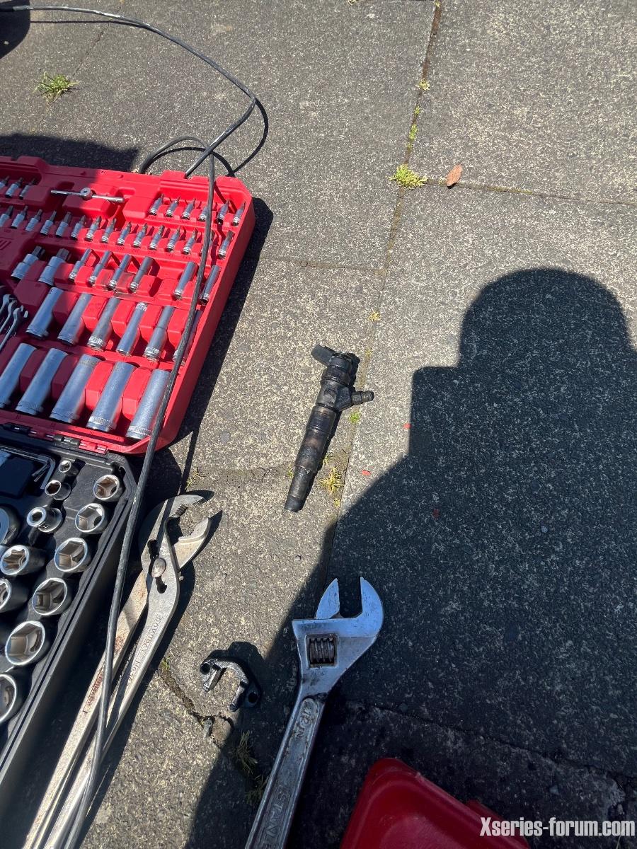

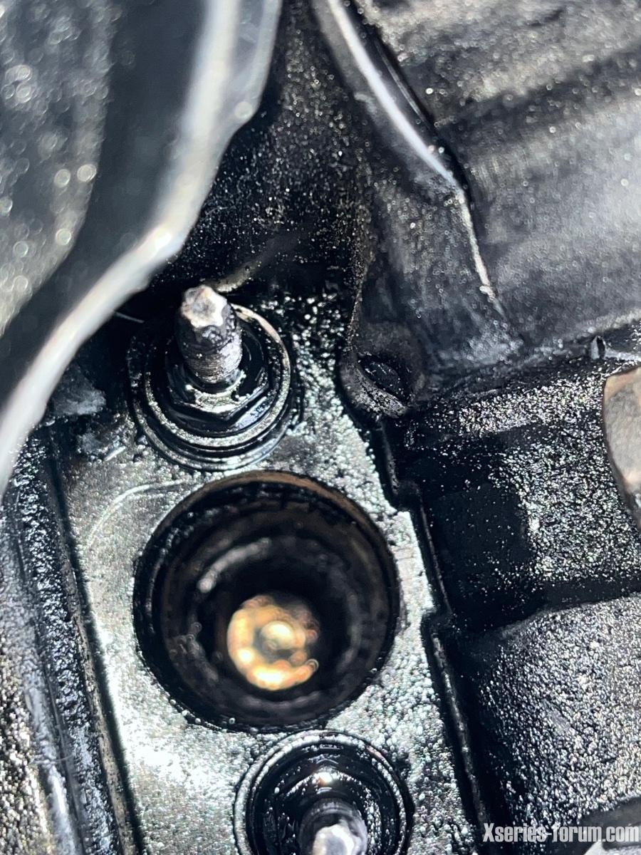

Hello everyone ! So injector arrived so thought I’d get on and start pulling the old one to replace. Anyway all goes well then i hit a snag.. found out why it failed
From images you can see the bottom end of the injector has worked its way off.
And seems to be stuck in the hole of where the injector sits
So now any suggestions on how I’d get this thing out would be lovely .. any kinda tool I can purchase that will push out and pull the bugger out
