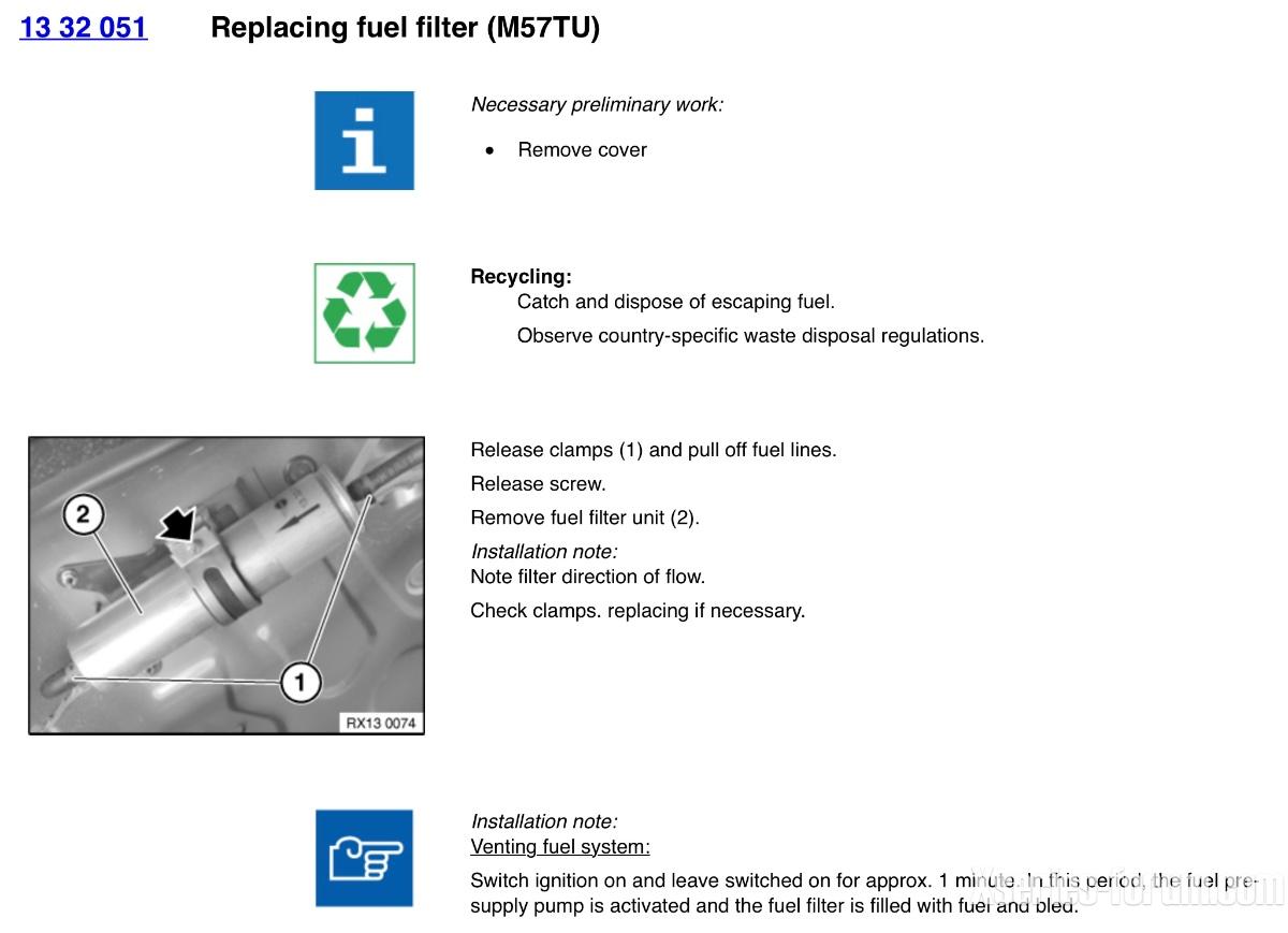

If it’s that vintage then leave the glowplugs alone for the time being - as said they can be a nightmare without proper prep. No idea about the diagnostics tool you have as I use Carly and that has it’s own adapter. Fuel side sounds to be an issue. The filter is under the passenger side

I jacked the car up to change the filter and did not bother doing it. With the car on Axel stands, its still tight space to work with. I will succeed in getting the under trays off but there is no way I'll be able to put it back so thought this might be a job better done in a garage.
I spoke to a mechanic and he were adamant the issue can't be the filter since it starts up easily with the easy start. he said its very likely to be leaky injectors
