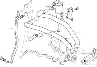

Some progress, got the smoke kit out again and initially there was nothing but as I’m using a bicycle pump to pressure the system I thought I needed to be closer so recruited the wife to pump while I fiddled and wobbled pipes. As soon as I touched 11 I got smoke. So replaced that and now have excellent idle and no stalling on petrol. So need to have a rethink/design of my smoke machine. LPG is still rough on idle but fine when moving. I also notice that the the idle on LPG is only around 550 rpm and lower and rougher when sitting in gear. So, anyone know how I can increase idle on LPG to the same level as it is on petrol. My reading suggests that the mixture is to lean at idle. On preview I see the item numbers don’t show. It’s the wobbly pipe.
