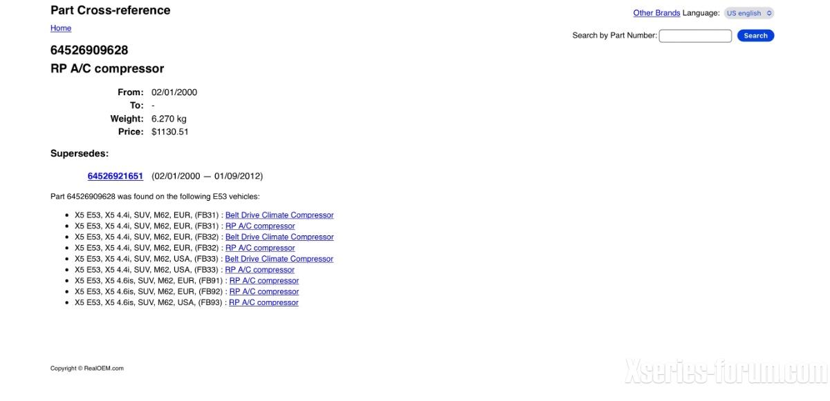

Can one of you experts please confirm that this part number is the correct ac compressor for an 01 E53 4.4.M62tu - 64526909628.
I’m finding new ones for circa £200 if that’s correct. Ta
- Posts: 19186
Engine vibration
This is the model list for E53….
