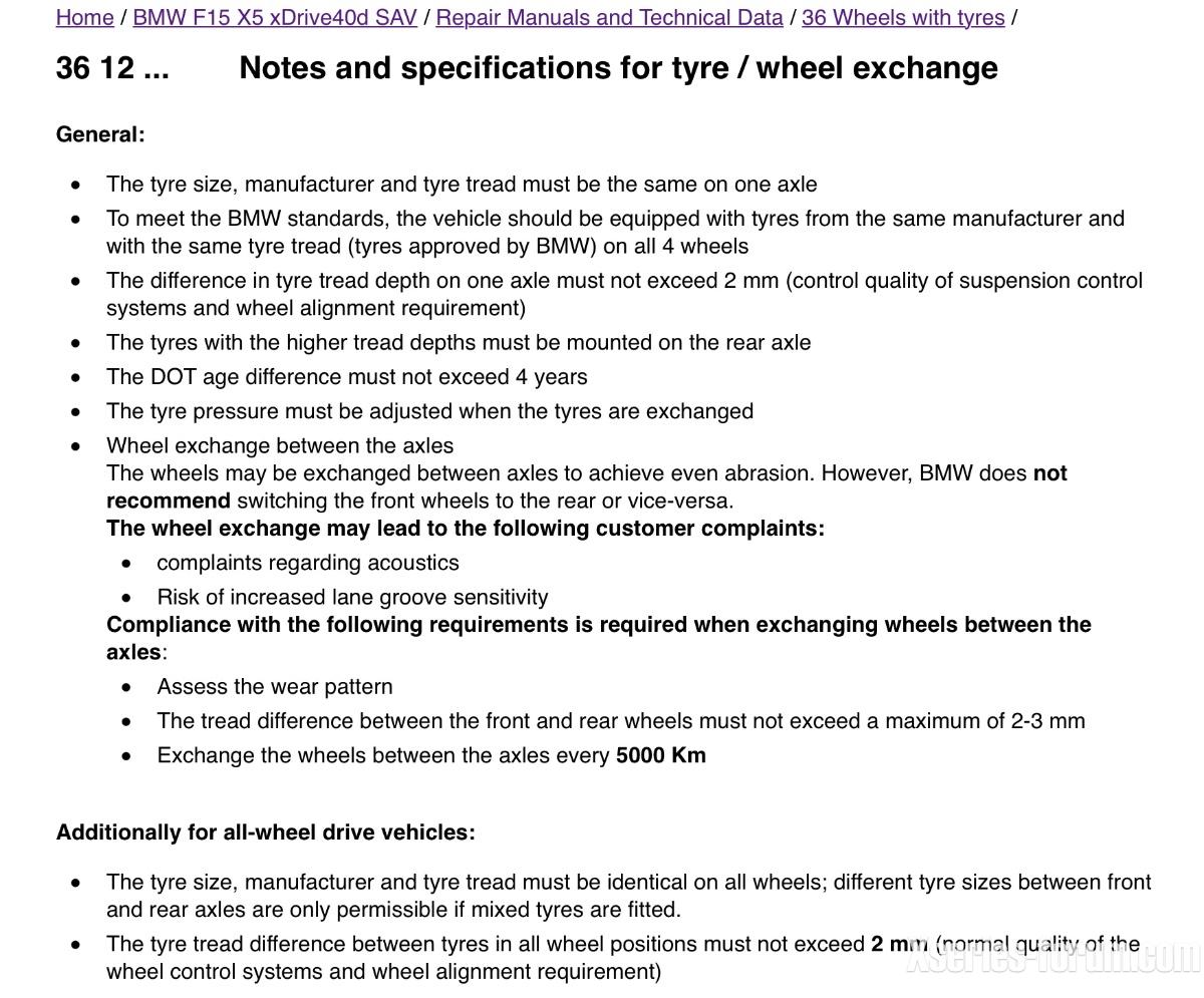

Here you go…..if I’m reading this right then it’s ideally a max of 2mm with tolerance up to 3mm except on XDrive cars. We have a limit of 2mm max :!:
I’ve never managed to get a set to last four years so will never have oldest > youngest that far apart. I’ve always had to change them as a set, and that’s expensive if a non-repairable puncture etc happens :cry:

Great thanks for that info, I'll also see if I can get any official from Lloyds BMW when I visit later in the week to give a definitive answer to confirm or change the above. My worst difference 1.5mm so just about OK.
Crazy when you think one puncture and you could end up with a bill for £1400 to £1600 with otherwise perfectly serviceable tyres on the other three wheels!!
