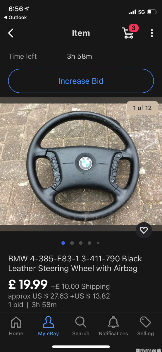

Hi, can i change my steering wheel to 2005 style, i have the old one like the attached pic

Your car was built on 2003-11-19. It may be possible as that wheel was used up until 2006. How much of it works depends upon what options you have on the car - its build spec - but it should fit. There are multiple versions depending upon options.
You need to check the ‘Steering’ section on the RealOEM link earlier (repeated below).
https://www.realoem.com/bmw/enUS/partgr ... BMW-X3_30i
Steering section is here: https://www.realoem.com/bmw/enUS/showpa ... Id=32_1464
Your build sheet (it’s how I know the build date) shows you have S249A and S534A. You don’t have S248A however.
Ideally you need to know which car that wheel came off so you can check the functions.
If you do decide to buy it you MUST disconnect the battery BEFORE doing any work. If you don’t then you will trigger a warning light and potentially fire the airbag. That would mean you have a really bad day.....

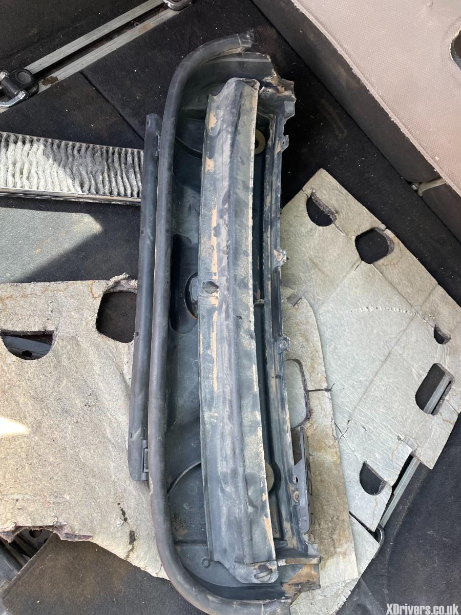

Thanks for the help, here is the part and also my steering wheel pic
- Posts: 19249
Re: Need help with parts
Where on earth has this car been stored - apart from bright Middle Eastern sunlight, and the missing filter has put sand and dust everywhere too. I can see why you need a new steering wheel and airbag module! That airbag is more likely to kill someone with shrapnel than save them from injury. The wheel for sale will fit and looks to be exactly the same as yours, but that’s all that anyone can offer in terms of what works, or doesn’t.
In the bottom image I’ve no idea where that piece of plastic (to the left) comes from though. Some kind of cover? It also looks as if some of the sound deadening material has been removed from somewhere too. What was the previous owner trying to do and gave up on?
You need to look carefully at the image on RealOEM and then match what you have against those drawings. It looks complete apart from items 2 & 3 on the earlier link, but no guarantees and you still need all of the fixings and a new cabin filter too.
