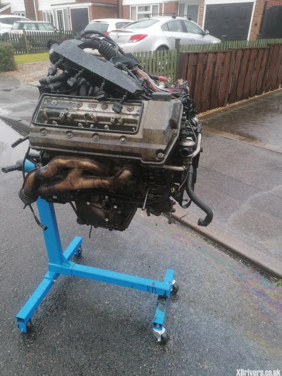

Post by thomp1983 » Sat Feb 06, 2021 1:15 pm
A big step in the right direction today, my luck was also in as a gent who lives further round my estate stopped as he walking past, turns out he had a range rover with the same engine and has the timing tools and crank locking tool I can borrow so that's a chunk of money saved

Post by thomp1983 » Sat Feb 06, 2021 3:10 pm
In for penny in for a grand is probably how it's going to turn out.
Full timing chain setup
2 headsets and headgaskets
Both sump gaskets
Front and rear crank seals
Vanos seals, hopefully the units are ok
Inspect pcv
Inspect bottom end
Gearbox service
That's a basic plan, anything else will depend on what I find when it comes apart, both heads will likely need skimming to ensure there flat
