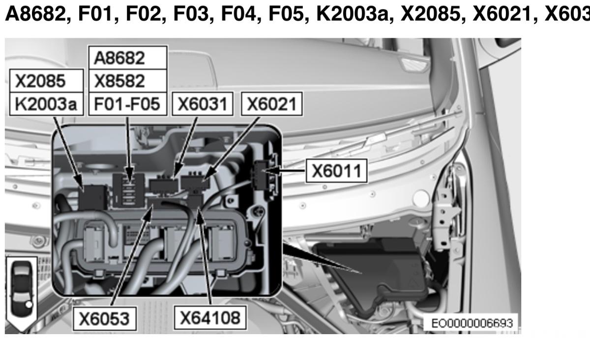

Had a search around today to see if I could find the fuse but no joy.
Posts: 19284
Re: Glow plugs?
Post by X5Sport » Thu Jan 14, 2021 8:41 pm
Fuse is F02 and is under the bonnet, right side (in front of the passenger seat) below the black scuttle, against the rear firewall, not in the main fuse board. I had to go and look it up. It’s 20A. I didn’t even know there were any fuses in there! A8682 is where the power for the glow plugs comes from.
Image below...

mr angry
Posts: 281
Location: Glasgow
Re: Glow plugs?
Post by mr angry » Thu Jan 14, 2021 8:44 pm
I had no idea there was a fusebox there. Cheers
Posts: 19284
Re: Glow plugs?
Post by X5Sport » Thu Jan 14, 2021 8:49 pm
The A8682 is apparently the fuse carrier for all engine electronics! Who knew ... :?
