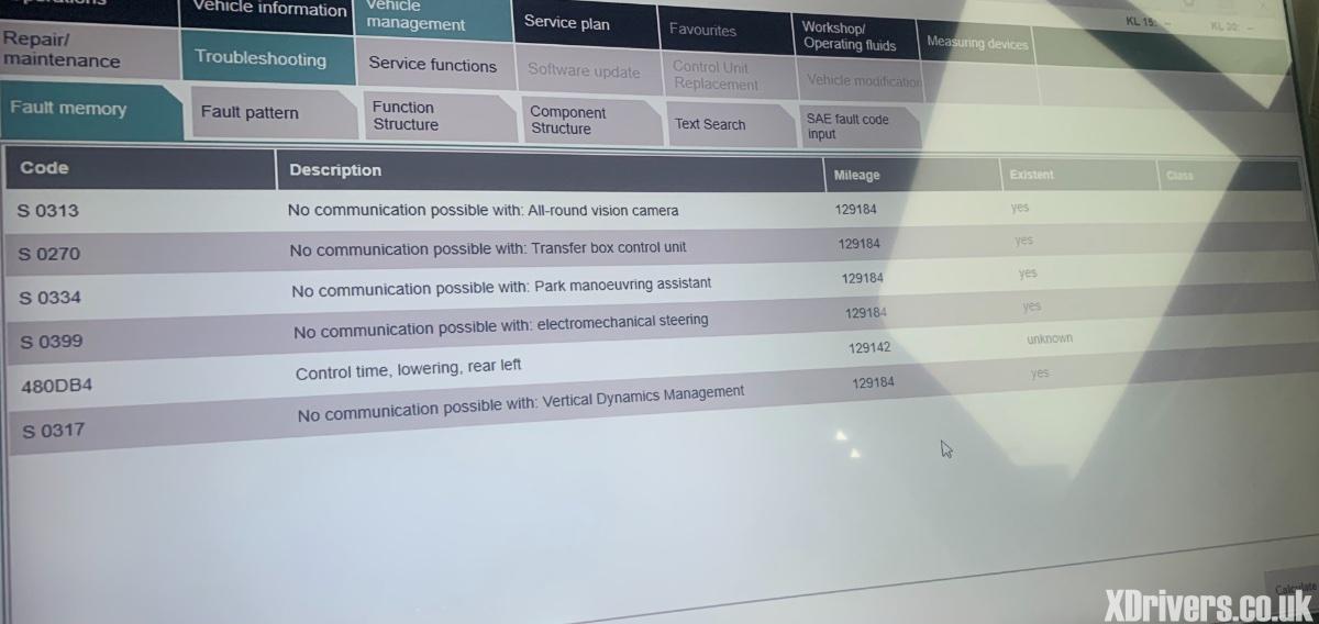

Bad new again, after a couple of weeks yesterday I decided to go on a long drive, and the chassis warning came back on idrive.
I plugged ista d, I’m getting the same code 480db4 and S0317
My X5 is riding high again, my question is does the air compressor has a function to deflate if it does maybe the compressor is faulty as it doesn’t deflates even when I run the deflate cycle from ista D, or could it be the valve block on the compressor

These are the errors I’m getting
