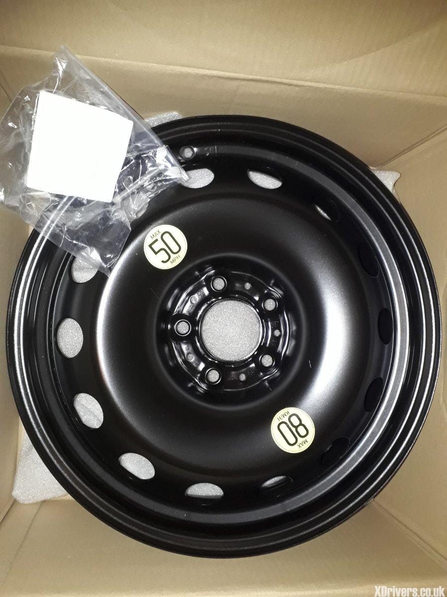

Was about to post up to this when I saw this. That's the main issue for you that the centre bores are different unless you carry a spigot ring too just for that occasion if it needs to go on the rear.sapphireblack wrote: Tue Sep 15, 2020 6:53 am
EDIT
Ignore all of this, centre bore size is wrong of courseonly 72.6 on the E53. 74.1 all round on an E70 and front of E71
X5 e70 space saver tyres

Its worse as the 4.8 alloy spare you have has a 72.6 CB meaning it doesn't fit the E70 at all and only the rear of an E71.

Yes E53 spare is a no go at all really. Ideally an E70 equivalent with a spigot for the rear when required.sapphireblack wrote: Wed Sep 16, 2020 8:20 am Its worse as the 4.8 alloy spare you have has a 72.6 CB meaning it doesn't fit the E70 at all and only the rear of an E71.![]()
Re: X5 e70 space saver tyres
Sadly, E70/71 owners only have a humble, heavy steel space saver option
Could have the E53s alloy CB enlarged but the offset still isnt ideal and Its all effort for something you hope never too need.

Yup agreed the space saver and tyre are a fair bit lighter than the standard size alloy and tyre so definitely not an issue.
Plenty of companies will bore the centre too for not much money but more of an issue with the spigot fitment perhaps.

Modding the E53 alloy is tempting as i have one. It would have to be bored to 74.1 for use on the front axle and perversely a spigot fitted to reduce it again to use on the rear. Strictly speaking a spacer and longer bolts required tooRaj wrote: Wed Sep 16, 2020 11:09 pm Yup agreed the space saver and tyre are a fair bit lighter than the standard size alloy and tyre so definitely not an issue.
All too much hassle for something i would hope never to need. Ths steel wheel is obviously 74.1 and i have a suitable spigot for use on the rear. That will do

Agree much easier to use the steel one.sapphireblack wrote: Thu Sep 17, 2020 6:30 am Modding the E53 alloy is tempting as i have one. It would have to be bored to 74.1 for use on the front axle and perversely a spigot fitted to reduce it again to use on the rear. Strictly speaking a spacer and longer bolts required too![]()
All too much hassle for something i would hope never to need. Ths steel wheel is obviously 74.1 and i have a suitable spigot for use on the rear. That will do![]()

I have a stud that screws in the hub to a bolt hole to set the wheel on when fitting , makes things possible at least
The mechanic I use says its a great help . The pramwheel arrived today and a long time since 5 inch wide wheels were of any interest lol and a google online shows places selling space savers are fitting 155.85.18 tyres for x5's mainly as they are 30 quid cheaper so I ordered of camskill £54 plus post for a contenental
Bought the little wingnut /stud to to hold it in of bmw
Lets hope its never needed !

Nice. I’ve got one of those studs too but tbh I’ve never used it as ended up going with a full stud conversions on all the cars lol. Why have one stud to align the wheel when you can have all 5
Go big or go home I say
