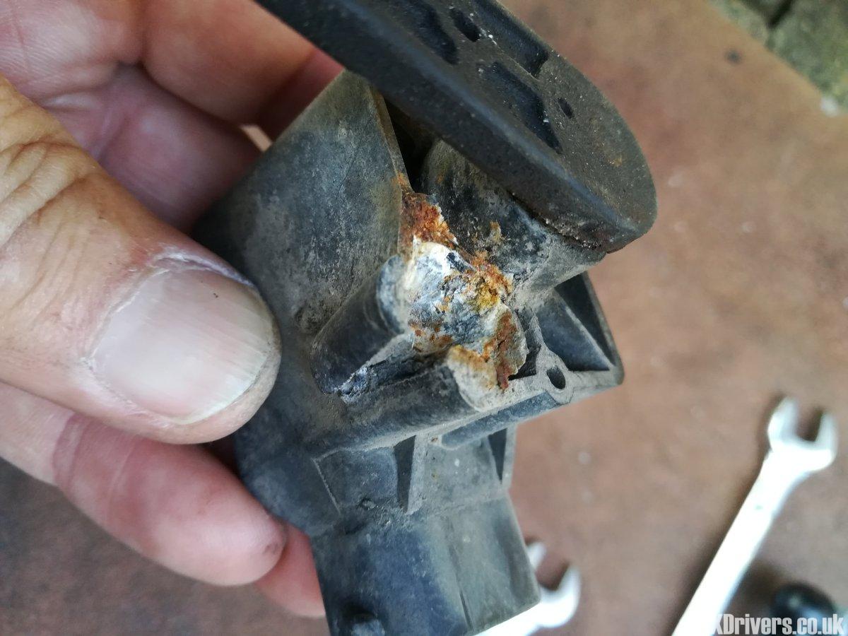

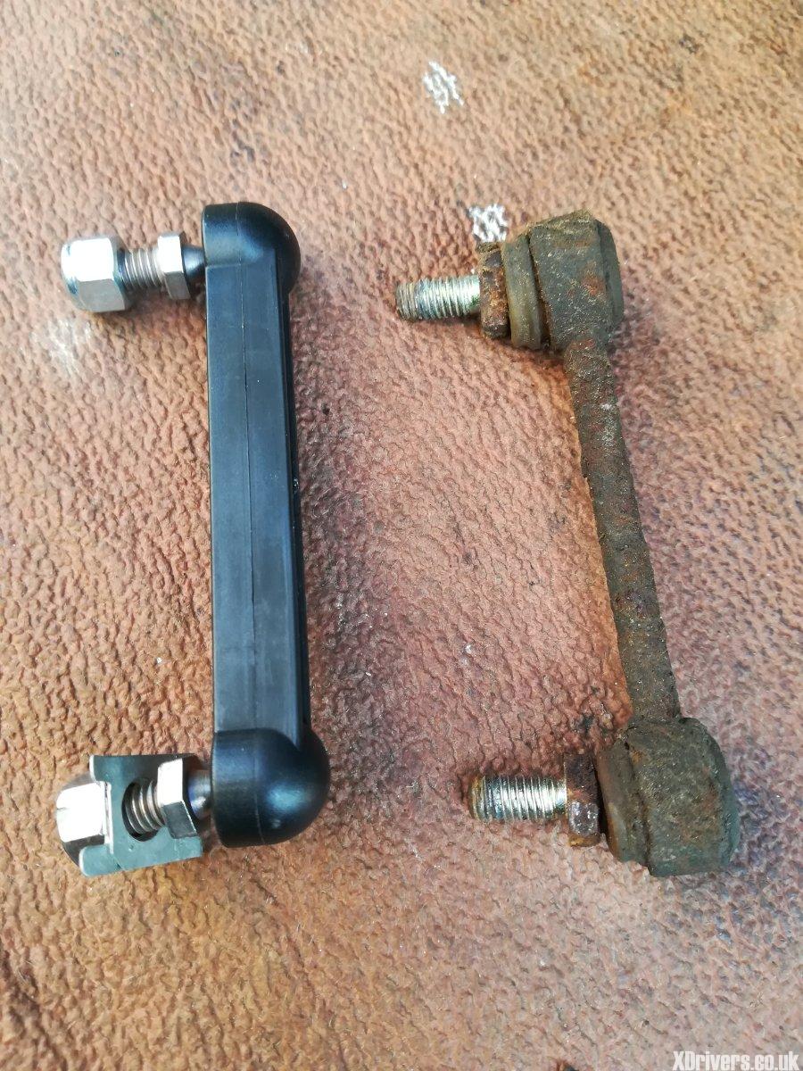

I knew it would be agro.. The little rods came off easily but so did the o/S sensor when the plastic body came away from the bracket...
Posts: 588
Location: Cambridge
Re: Rear suspension problem
Post by Themoog2 » Fri Sep 18, 2020 1:34 pm
The cause was seized ball joints pushing on the sensors old mounting bolts and age. I'm collecting a new bmw sensor tomorrow and I've ordered a cheap one for the n/S as that looked a bit dodgy. It may be good practice to replace the front headlight sensors too..

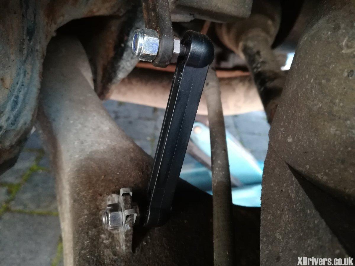

Put it all back together with a new sensor and drove it about for a while.
I left it for an hour and 1/2 and its on its butt again on the o/S where the new sensor is.
It pumps up ok but o/S is still 15 mm lower than n/S.
What do you think? Air bag leak.. Or could the old sensor still on the n/S be the cause..

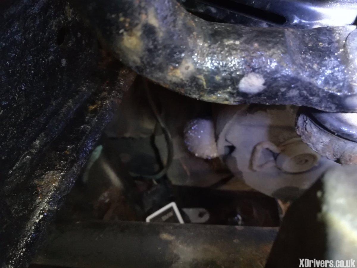

After not bothering with the car all weekend I thought I would have a butchers with some soapy water spray. Low and behold the o/s air bag is leaking.
Raj
Posts: 4512
Location: Midlands
Post by Raj » Mon Sep 21, 2020 9:02 am
Ah bugger, which means the pump is over working itself too so not ideal. Does explain everything though now.
