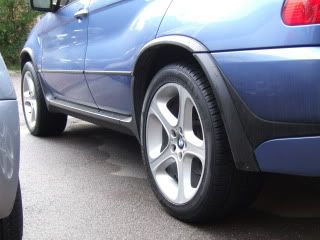

Its images like this, the rear alloy just does not look right to me, too far 'in' to the bodywork

That doesn't look right.
Unless photographed from a very awkward angle I can only speculate that X5 may be fitted with non genuine alloys, (based on the style 87), be fitted with wrong tyres, or perhaps have a front rim fitted to the offside rear................Something is definitely wrong in that image though as my 19's fill the rear arches better.

Thats a set of fronts on the back, the dish is not deep enough like the OEM rear ones are.

Sanj is right its defo fronts on the back as its the same as mine...Try and geta pair of rears they're like rocking horse shit....Loads of fronts for sale as peeps putting 10.5 rears on the front...
