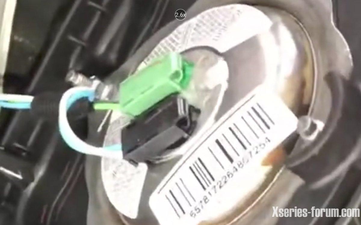

More out of curiosity, as i dont imagine, I'll be disturbing an airbag again soon, the revised mini loom connections defeated me, i have no idea how to release these revised plugs from the airbag. The original type were easy, anyone know how these newer types are disconnected?

Looking at the picture, It looks as if both plugs have a fold-over cover which needs carefully lifting from the left hand end (could be a latch that engages under that end) and the connector may be under there. I would strongly recommend wearing an anti-static strap whilst having a look.

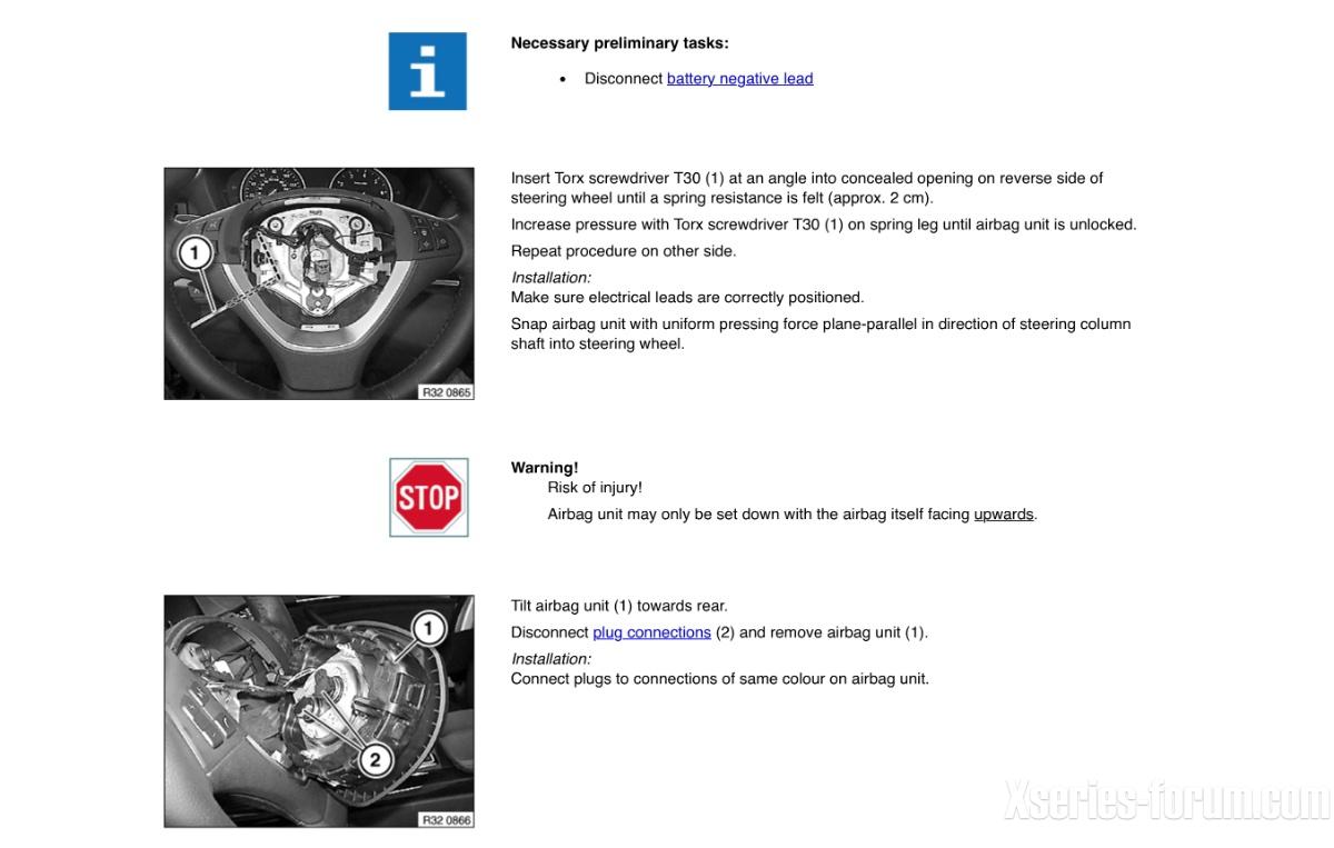

Looking at the only manual I have, it looks as if the connections are completely different!
I wonder if the connector change indicates a post Takata airbag change under recall.

I'm inclined to agree with your thoughts having studied this piccy more closely. I wish I'd been more patient and investigated further at the time, but obviously, i didnt want to break anything. I won't be disturbing it again anytime soon though, that's for sure.
You could well be right regarding the fitment change being a post Takata 'upgrade' and a visual identifier that it has been replaced. Maybe the simple press and lock original connection has also changed underneath, if this is indeed a folding cover of some sort. It means as part of the recall, the mini loom inside the steering wheel was also changed.

A bit more clarity on the airbag replacement recall. I came upon some images that show the difference between old and new connections. The plugs appear to have subtlety different pin positions, which probably explains the revised plugs that confused me a bit when swapping the steering wheel. Probably fair to say the yellow label type have been superseded.
