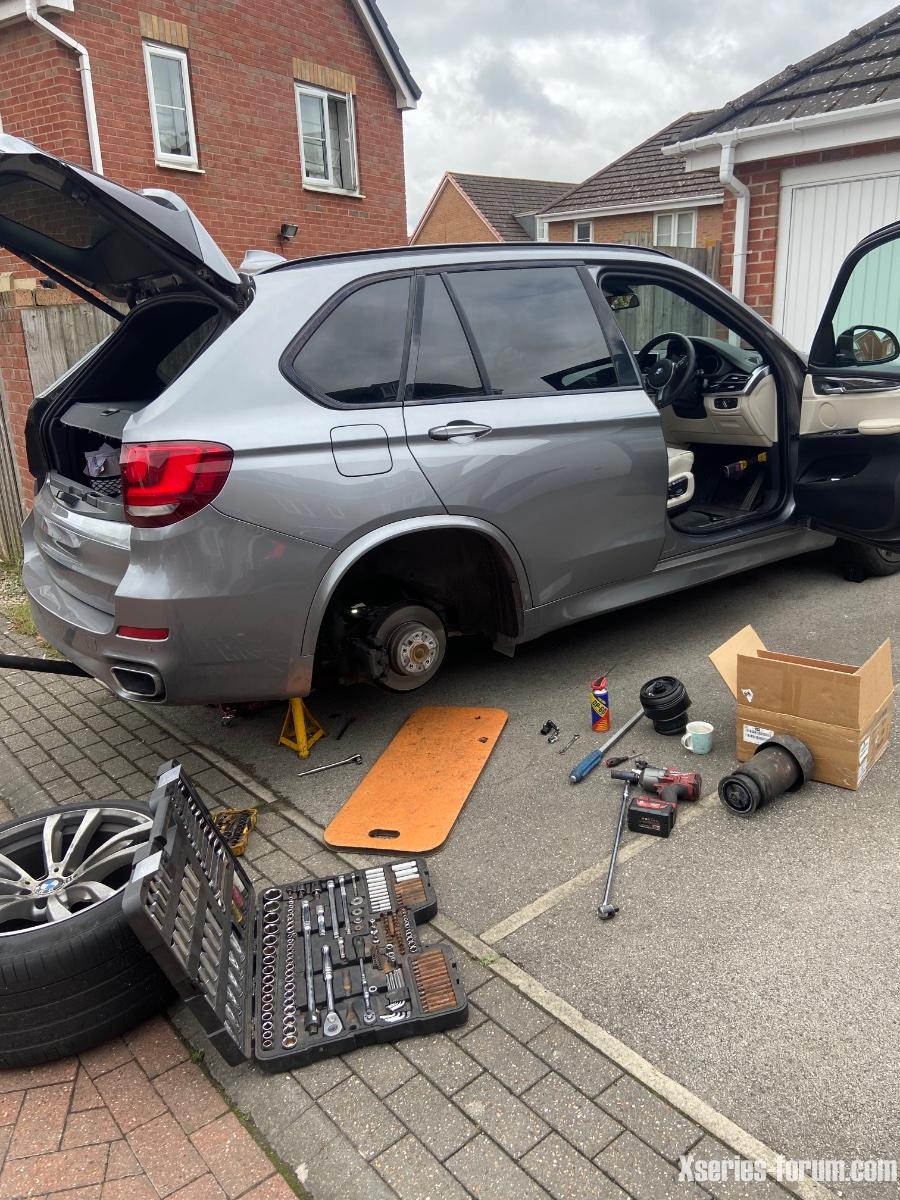

Posting to help others in the future.

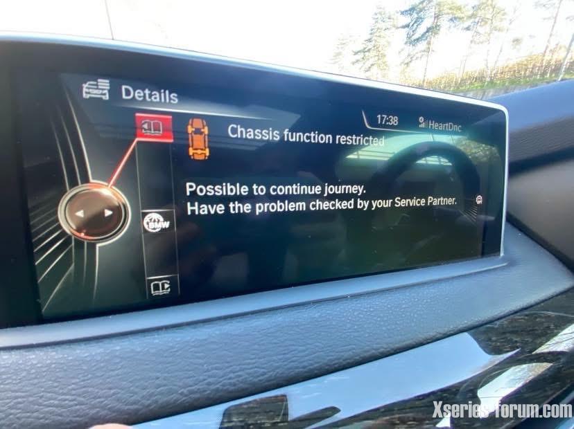

So my car threw up this error
I worked out it was the ride height level sensor. Purchased the below from amazon
https://amzn.eu/d/gjHGIra
And as the car had sagged I bought a pair of new bags from Amazon
https://amzn.eu/d/azfI0yN
All fitted and no more errors 👍
Hope this helps someone. Imagine the same process and possibly parts may work for E70.
