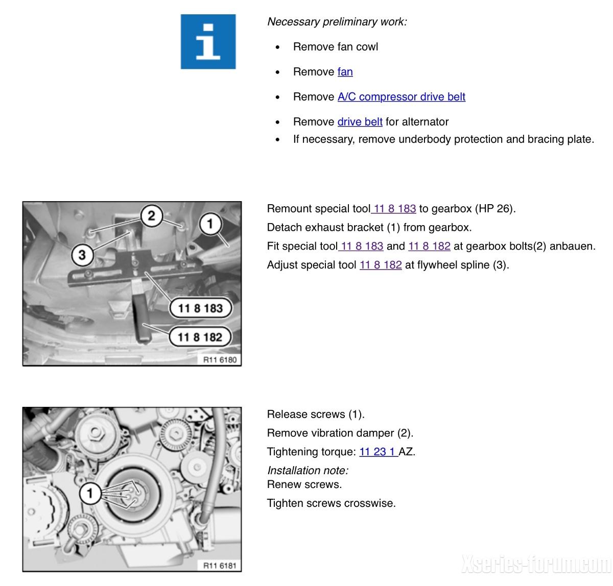

BMW of course use a special tool that attaches as below (for HP26 auto):

Torque specs:
11 23 Vibration Damper Tightening Torques
1AZ Torsion damper to crankshaft
M57TU M10x86 Replace screws
1st jointing torque 20 Nm
2nd angle of rotation 120 °

Why do BMW and easy never go together....... :headbang:

I don't believe in BMW 'Special Tools', managed to lock the flywheel from undercar with flat head screw driver (Two Man Job), et volia!

There’s pretty much always a way around ‘special’ tools. All you need is a bit of ingenuity - or in your case two extra hands and a large screwdriver :D
