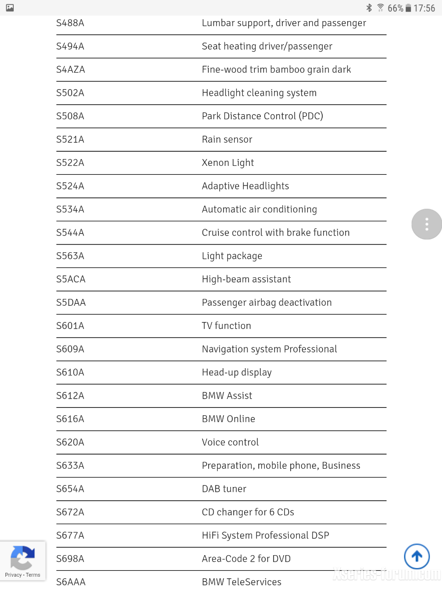

Voice Control is S620A on my E71 and I would assume is the same in the E70.

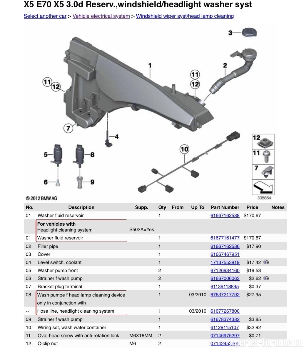

Headlight washers were option S502A and were mandatory in Europe with Xenon/HID lighting. If the lights were ordered, the washers came too. The front wing has a different part number for non-headlight washer system cars. It’s possible your car was ordered with the option anyway. They do have a habit of sticking! No easy way to check as the tank is in the wing making counting pumps a little difficult! I think there would be 3. Windscreen; Rear screen and headlight system.

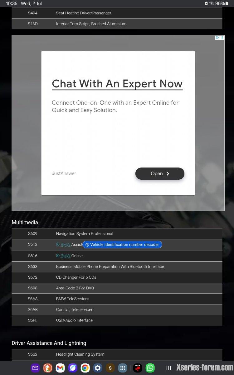

Well the US spec LHD comment from the dealership did make me smile, misinformation at its best.
I didn't think to compare both build specs and unsurprisingly, the E71 has voice command.
The E70 as I've said previously is basically poverty spec. The inaccuracies on the E70's build confuses me though, but for sure S620 is absent. Engine code is M57N2

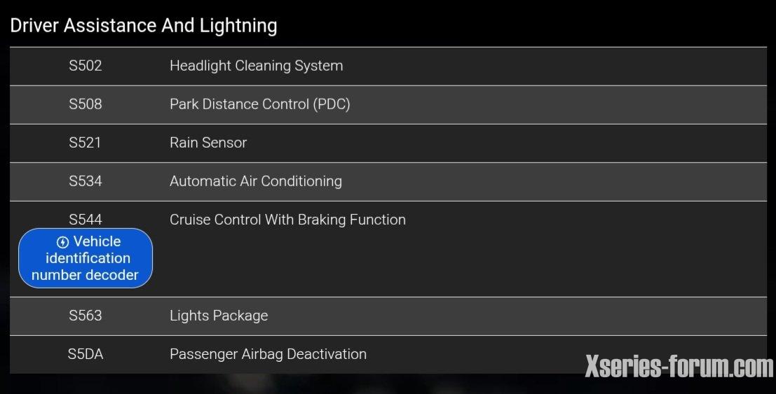

I am scratching my head now in relation to headlamp washing. I've activated the screen washer countless times to properly set up a replacement jet. At no point did the headlights get wet. I wonder if the bumper jet covers can be lifted manually, just to see what, if anything, lurks underneath them. If there's a buggered motor, it will stay that way. Having had the E71s washer tank investigated at a main dealer, I'm in no rush to invite another £300 + bill for the ridiculous strip down required to access the water tank
And confirmation that headlight washers are shown on the build.

It transpires this car does have the headlight wash option according to BMW UK. That is now a frustration as it is not working, though im half sure i heard a pump run for a very brief moment but hasnt since. I won't be Investing the money it required to resolve this on the X6.
