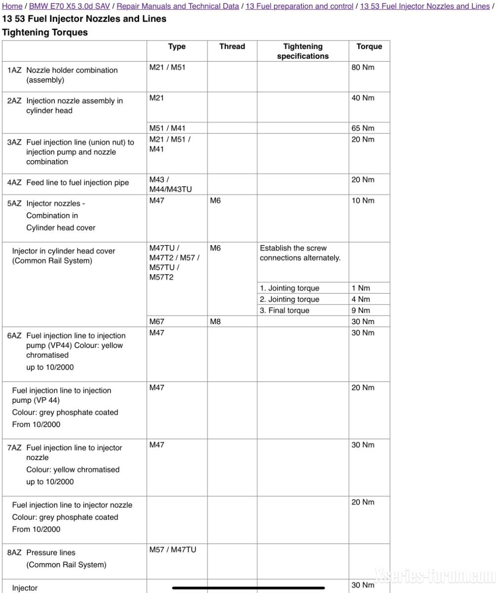

Has anyone got the tightening torque for the injector clamp as I need to get at this soon , I'm finding various specs online , I think its 10 nm ?

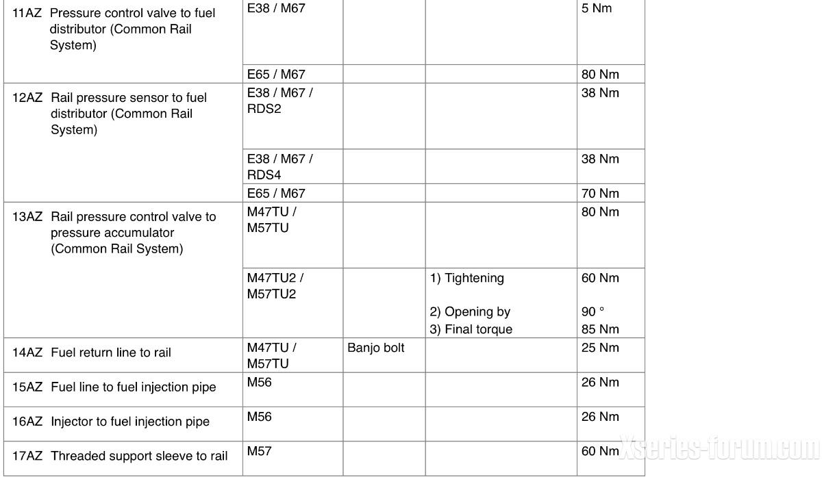

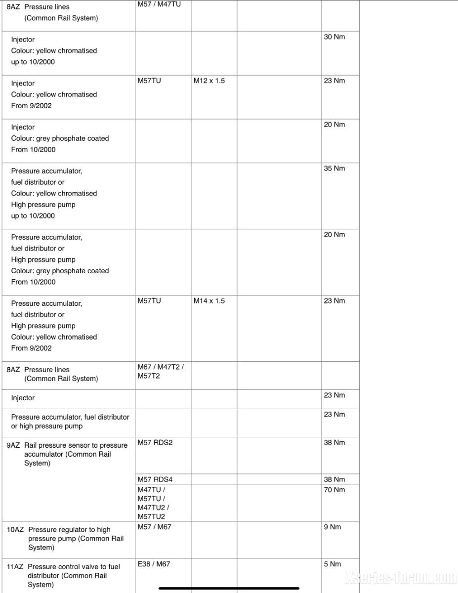

Posts: 19299
E70 3.0D cutting out
Post by X5Sport » Fri Jul 04, 2025 9:18 pm
This help? Bottom of the page is for lines, rather than what I think you’re needing. I’ll add them into the follow on post..
Posts: 19299
Post by X5Sport » Fri Jul 04, 2025 9:23 pm
Here;s the rest of that page…
Posts: 1747
Post by Leslie » Fri Jul 04, 2025 10:41 pm
Thanks you :thumbsup: ,
"Injector to cylinder head cover" should be it 1, 4 then 9nm for M57T2 basically tighten evenly ,I knew it was surprising low , the lines are 23 nm but there is no way of attaching a torque wrench due to the lines being in the way unless you had "crows feet" wrenches but there isn't much room in there for that either.The injector clamp torque is the important bit It says m6 but I'm sure its m8 but won't know till I'm in there and the 30nm below it sounds too high for m67 :rofl:
