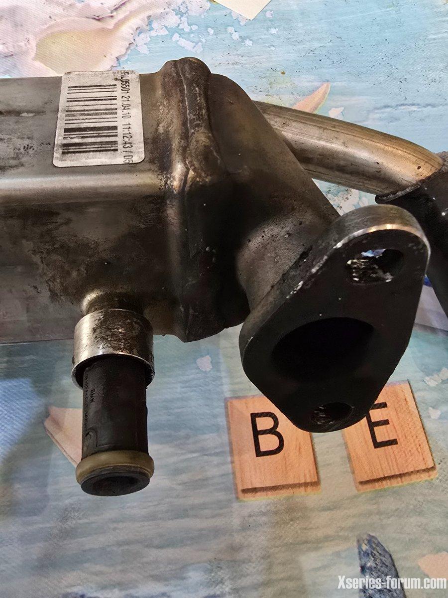

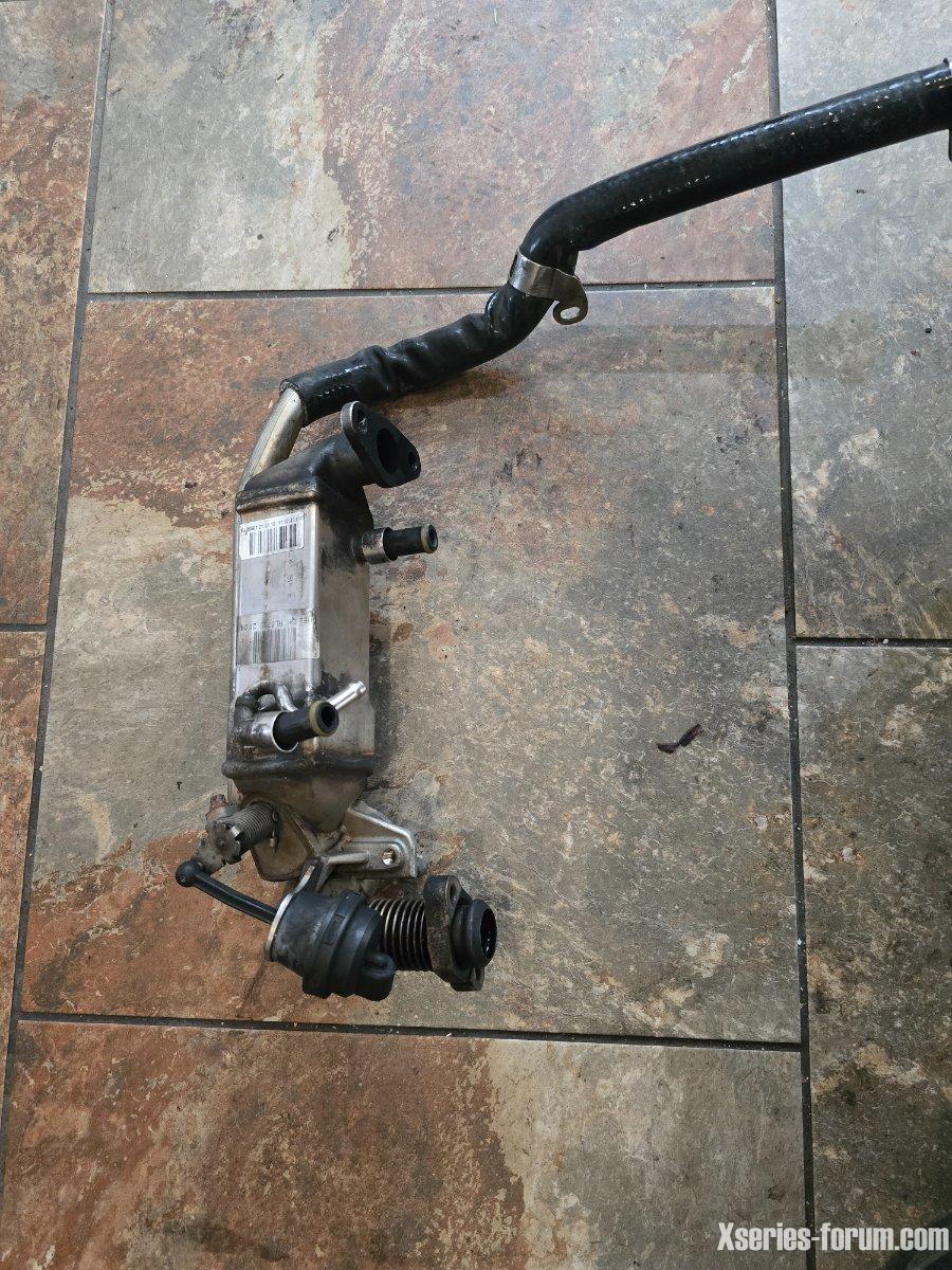

removed my egr cooler but cannot find the corect one to replace, lots for sale that say they will fit but none like mine, mine has a 90degree bend welded on the end all i can find have a straight flange, any ideas please

Stick the last 7 of your VIN into Realoem (in the Serial Number box) and that should pull up your car and from there a part number. Searching for that on line should then come up with options.
It will be in the <Engine> section, then <pollutant reduction cooling>.
