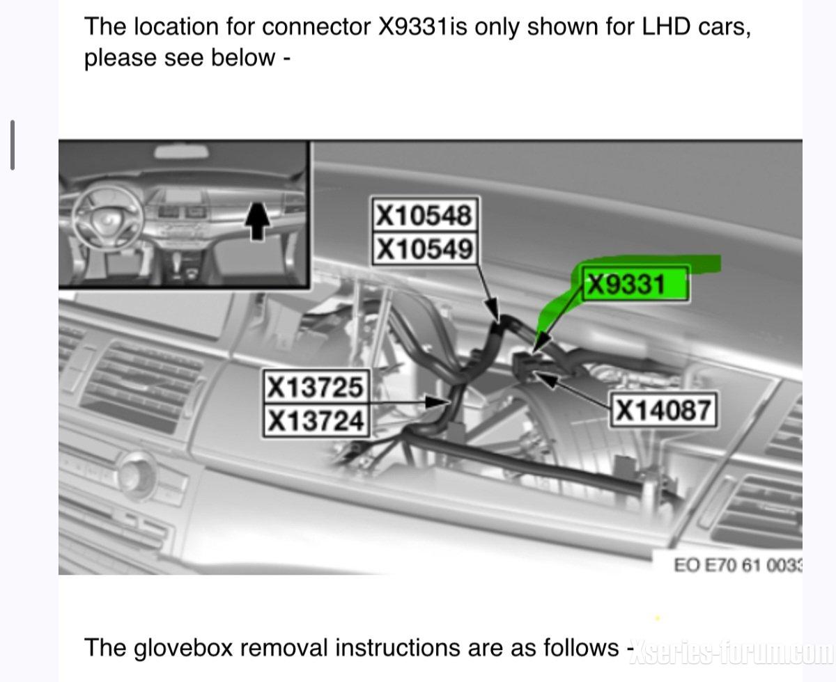

I had a mobile auto electrician visit recently, and after some time dismantling and circuit testing, the good news is the diversity aerial is good. Power to it is the issue. This was traced to a junction connector as depicted.
The happy coincidence may be, is the car is at the dealership Thursday and Friday for its airbag recall, so dash out anyway? And the angel eye bulb replacement that BMW are paying for. My only thought is are RHD cars wired the same or in opposite configuration? Regardless, i hope by Friday evening I'll have a car with remote locking functioning, safe airbags and a full compliment of angel eye DRLs

I'd think the wiring will be a mirror image for LHD , not sure if they take the dash out as that would be a big job and the passenger airbag should be removable without that but maybe it isn't.Its an all day job or mine was anyway.

I was assured the passenger airbag swap required the dash out on my X6, and an X5 is obviously the same. But this was dealership representatives who we know are not so well informed. If the wiring is mirrored for RHD cars it should be a doddle to access the wiring shown. The parts price, no idea, but labour should be minimal if already working in the space behind the glovebox 🤞

Looking at the pic again it will be above passenger airbag so yes they will be right at it which is a bit of a result as labour would be pricey if they had to do it otherwise.

So the saga continues. The junction connector X9331 is apparently only applicable to 2007/8 built cars. The dealership was willing to deal with this during the airbag replacement for free, but the connector is not behind the glovebox. BMW technical department advised the dealers that on a 2009 built car it was relocated to the boot lower left side, but didnt elaborate on where exactly. I have invited the mobile auto electrician to return to assist me again. If he can't find it, or does and its not the problem, it will have to remain a key entry only car. Its already cost £340 and i don't want to commit more funds to solving it.
