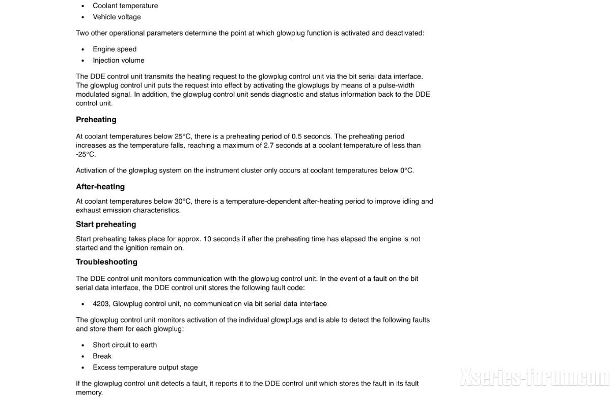

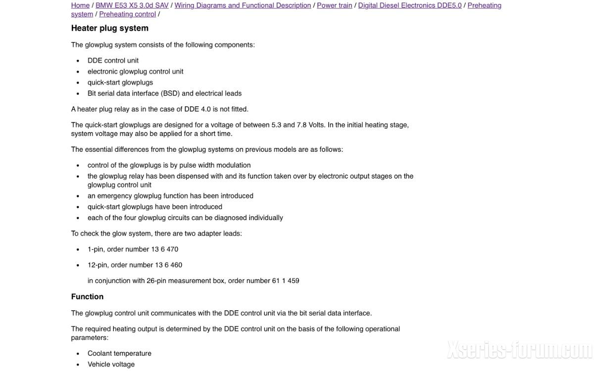

- Posts: 19242
Glow plug issue
Functional description of the system…
