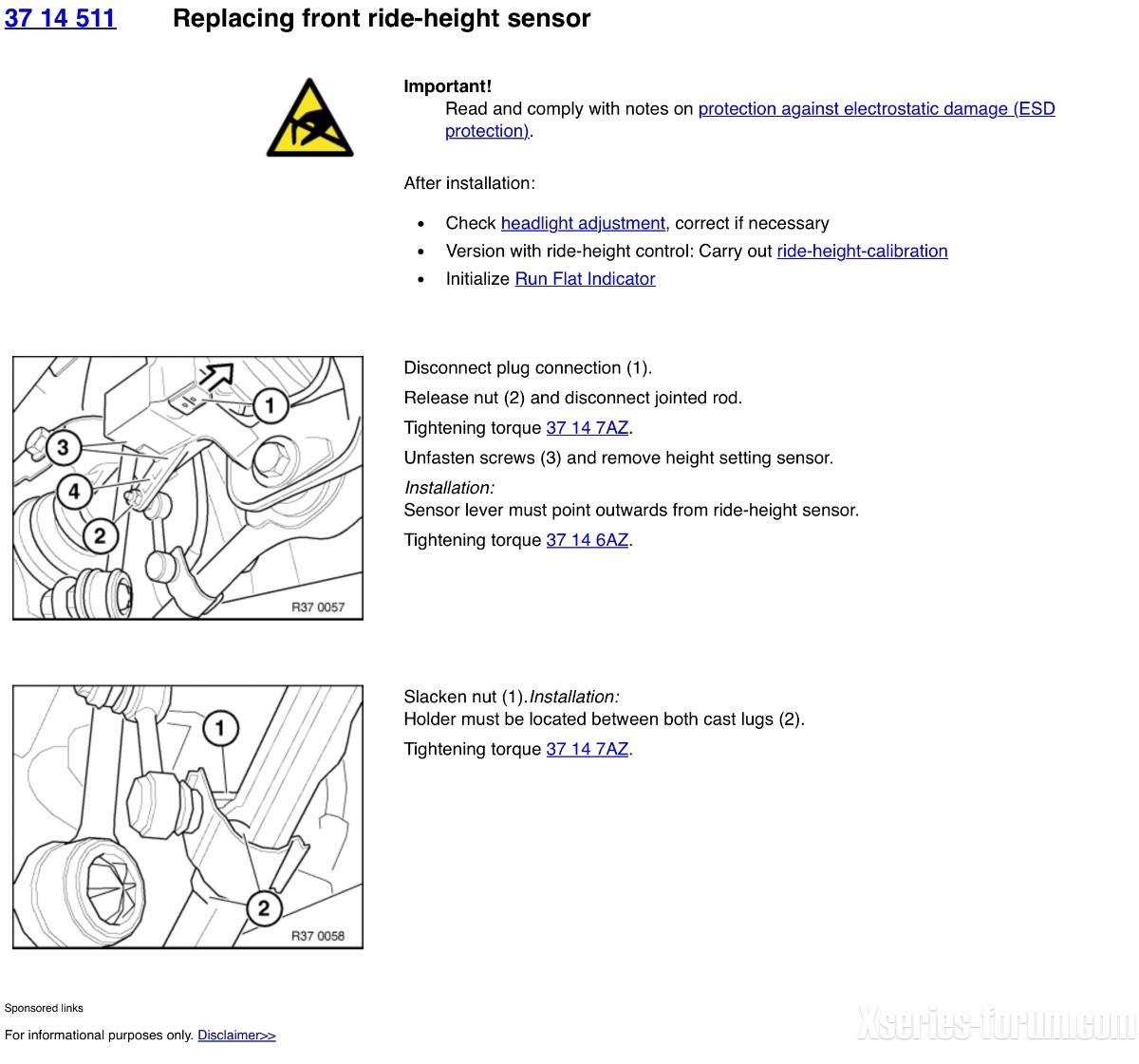

So inspected the sensor thought I’d have the lights on in the dark, I’m under there with some tools decided let’s test something took the arm off that attached to the bar and thought let’s move it and see if it actually works.. funny enough no matter how much I moved it up and down the lights didn’t really move at all, frustrating.. so suppose in the day time I need to try get the model number off it and seek a new sensor as in theory the sensor seems rather fluffed. Anyway another question does the rear sensors have any input on this ? Air bags seem to work normal level is fine there’s been no major ride height changes but maybe the compensate for the sensor not working on the front ? I’ve now disconnected the front sensor and readjusted the front headlights so now I can drive at night, any input would be appreciated and if anyone has any images of how it should look once I do seek a new sensor to replace the said duffed one

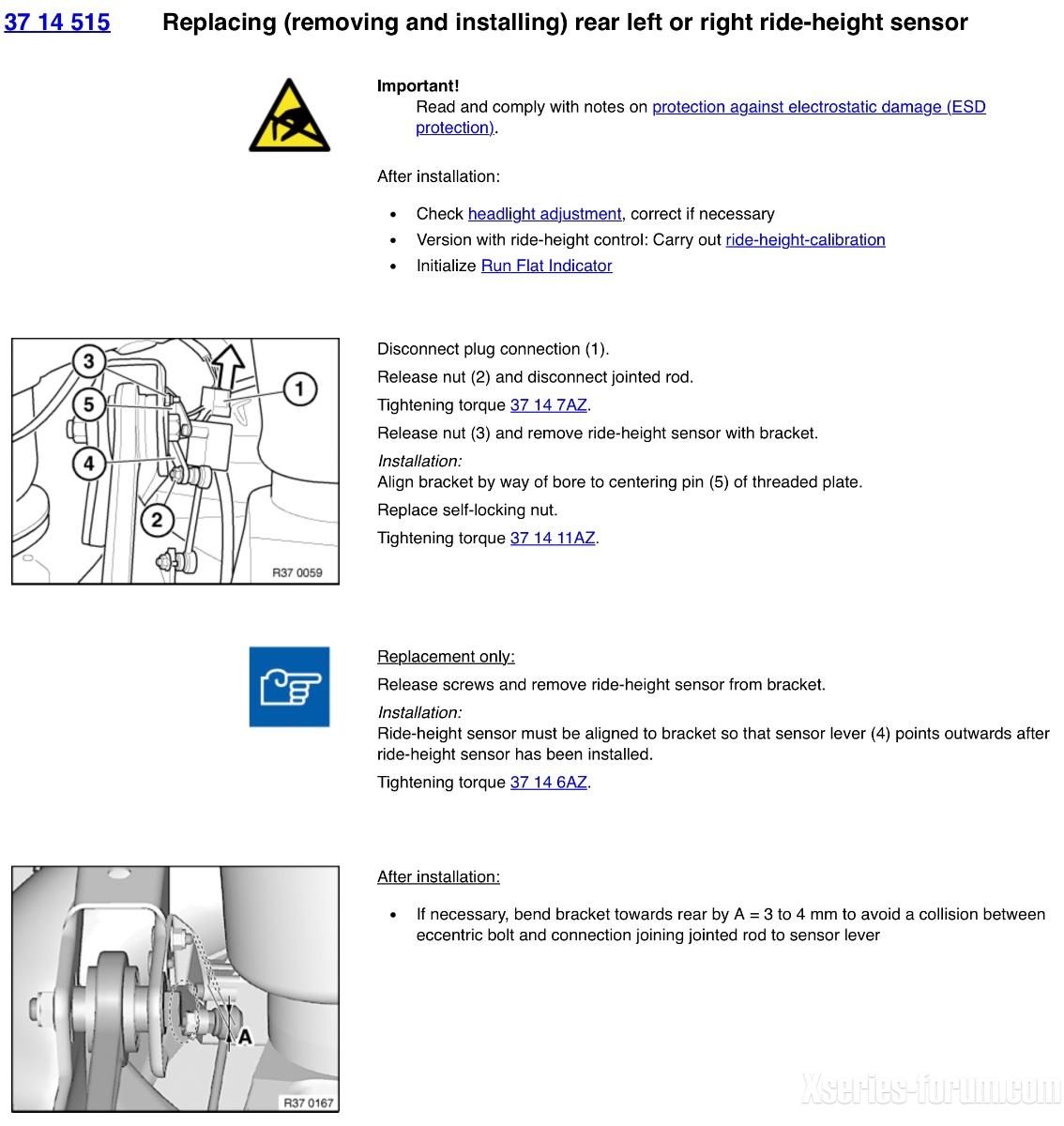

I think the system uses both sensors - it would need to in the case of a heavy load in the back.
These might help….

Is the rear one not called a headlight level sensor in realoem.
Had to buy one some time ago and sure that was what they called it so it might play a part in the headlight leveling ???.
Posts: 1995
Headlight self levelling fun
Post by henrym3 » Thu Sep 05, 2024 10:58 am
You’re absolutely right, I just looked at the parts catalog and they call the rear sensors as headlight vertical aim. You learn some every day. Should have known that X5Sport was right.
