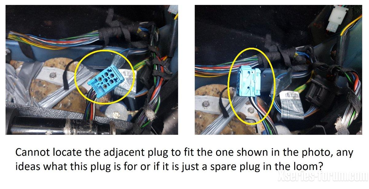

After repair to base of the O/S rear boot floor back well I cannot locate the adjacent plug to fit the one shown in the photo, yeah should of taken a photo or two, but we all have to live and learn, or my case live, learn, totally forget (very bad memory). :headbang: :headbang: :censored: :censored: , any ideas what this plug is for or if it is just a spare plug in the loom?

It might be one of two connectors that would be used if you had adjustable rear seats fitted. If it is, there should be a matching one on the other side of the back seat. E53s were built with complete looms (unlike all subsequent models) which made adding options a breeze.
There might be a thread about it on here from about 15 years ago. I’m pretty sure that this has come up before, if my ancient memory is still good!
They connected to two switches, one each side of the rear seat in range of the passengers, and one each side just inside the tailgate so you could adjust the seat rake to increase boot space.

Cheers, haven't got elec rear seats, so make sense.

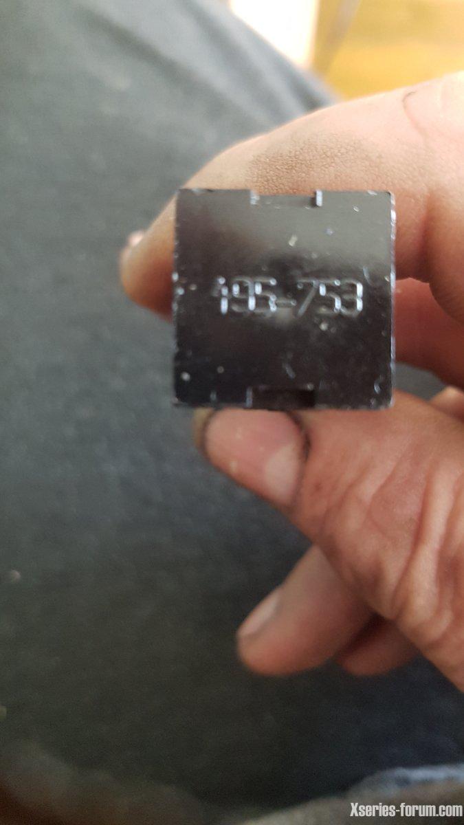

I found this part in the boot after removing all the tools after working on my X5, it has the following number 495 753, comes up as a trunk switch on a foreign web page, with part number 83 30 0 495 753, but not found or listed on oem catalog or uk bmw parts supplies. All I'd like to know where should it be located/ positioned on the vehicle??

Tried two different AI based image matching systems and no success. It was a long shot anyway, but worth a try. I’ve never seen a part in a BMW without a complete number (7 or 11 digits) so I’m not certain this isn’t a component of a sub-assembly and that assembly would have a part number.
I’ve tried various database searches and nothing comes back with a BMW hit. Or at least nothing that makes any sense - it’s an inner panel for certain BMWs, but that doesn’t look like an inner panel!
There don’t appear to be any fixing points either. What’s at the other end from the part number?

No probs many thanks for having a look about for me, I found the part in the side cubby-hole so I think it was surplus to requirements.
