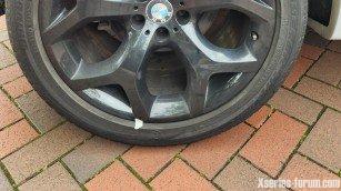

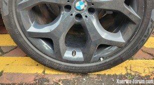

I stuck some masking tape on all the wheels in the 6 o'clock position. Drove it for a few yards and then checked them. The front 2 were almost perfectly aligned, the rear two were out though. The offside rear was around the 6.30 mark and nearside was more towards the 5.30 mark. The offside is worn and needs replacing so I'll replace both of them together. Both the front tyres have around 4mm tread left at the moment.

What where then markings like front to rear.
Where the fronts at 6 and rears as pictured.
I think that is what you are saying but just checking.

Yes, the fronts were dead on 6, the rears as pictured
